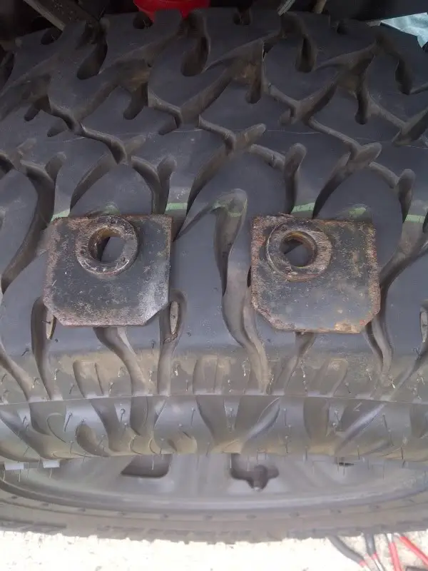

Do i need to put these ford oem adjusting washers back in even if i bought the moog caster/camber bolt kit?
I didnt put these back in but do i need to?
This is the upper control arm installed with the moog caster/camber bolt kit.
The oem's are replaced by the Moogs.
