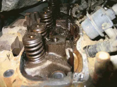

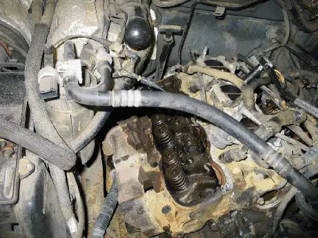

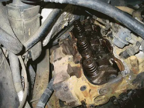

I gotta be missing something... the manifod basically fell right apart once all the bolts were gone... it's in place but pulls out of the way with ease. Hopefully these photos might help someone give me direction. Thank you

Thats a real rust bucket, keep prying at multiple points, good luck

I just did the same thing on my 94...you have to take the intake manifold off first. From the pictures it looks like its still there unless thats a picture from earlier in the tear down.
By all means DON'T PRY ON IT UNTIL YOU HAVE THE INTAKE OUT!!!
hope this helps...
hmmm
Intake manifold removal is MANDATORY in removing the cylinder heads!
