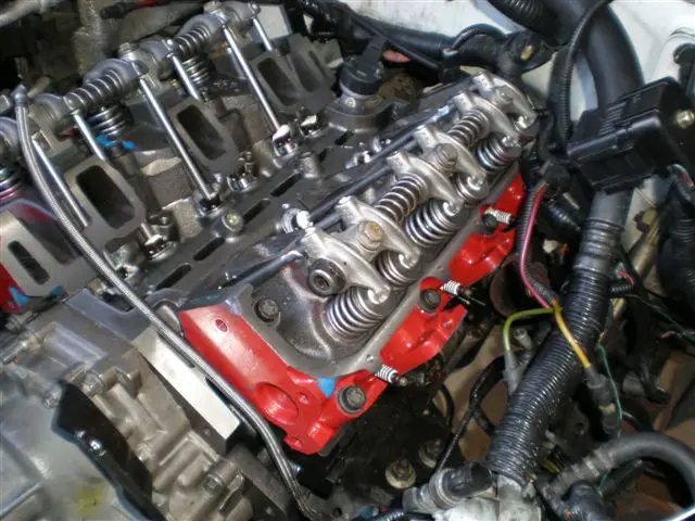

Your rockers should look like this...
Check out the rockers on this top end ... Yours should look like these..As you can see there are no adjustments here except pushrods and shims under the rocker arm stand...

Very good, to know, now I don't feel as dumb!
