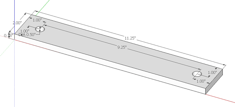

those warrior shackles are extremely simple, and i didn't feel like waiting a few days to get a set delivered, so i just made a pair out of scrap bar stock i had lying around. my calculations were a little off though, and i only ended up with 1" of lift instead of the 2" i had hoped for.
that was with 7 1/4" between the bolt holes. about what is the distance between the bolts on the warrior shackles?
thanks,
tom
nevermind, figured out where in my math i went wrong
IIRC it was 8.5... somewhere on here there is a drawing or diagram of the shackles. bascially, they are 3" longer than stock..

thanks. i came up with a bolt to bolt spacing of about 9 - 9.5" to yield a lift of 2.25"... going to give that a shot tomorrow.

great thanks. i built myself a set of these today... 9 1/4" bolt spacing, so slightly larger than the war-153's. i'll upload some pictures later on.

Great thread!!...I guess I will build my own set too then...my only question is which bolt spacing will give me a 2.25" lift...I plan on a new rear bumper, spare tire relocate and a couple of gas cans...so I will be adding a couple of lbs in the rear.
9.25" or 9.5" bolt spacing...stock mono leaf spring in the rear.

the rule for shackles is this:
Amount of lift you want x 2 = Amount longer your new shackles must be over stock
