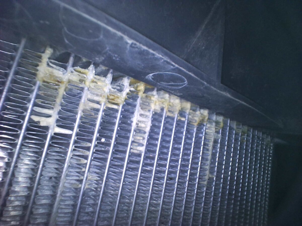

Well I had a chance to look at it today and it's definitely the radiator. Here's just one spot at the top.
