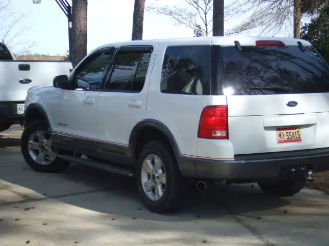

any pics of the truck or your accessaries?
only older, the trim is painted but its painted a gun metalish grey.
roof racks back on it now but i stripped it and did a light polish.

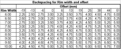

According to this chart
If the offset on a 16 X 7 is +44 that makes the backspacing 5.75??
Correct me if im wrong. I might be reading this wrong.
I said 4.5", I meant 5.5", but according to my calculations, A 16x7 Rim with a 44P offset should have a backspace of 5.25"

I'm not so sure about it either. But backspace is the distance from the back of the rim to the mounting face (hub). Offset is the distance from the rim centreline to the hub mounting face. So the way I work it is for an 8" rim with an offset of 0, the backspace is 4".

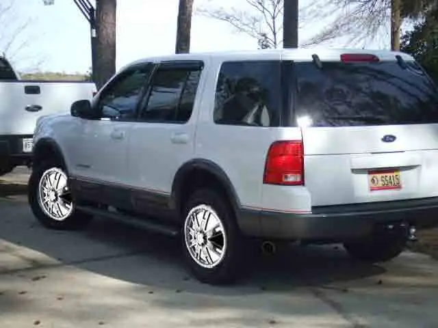

here dude -
not nearly my best work, but I thought I would contribute...
