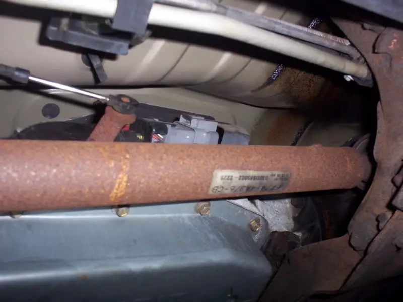

I tried to take a picture of the front drive shaft. Its not a double carden type. Its a CV type, with what looks like oil coming from it. Could that be my problem?
Here is some pics. Not the best as its hard to get under there.
Did you check the fluid levels on the TC and front diff? They have access holes for that.
Yes, I posted that earlier. All fluids are perfect,.
That CV joint leaking has me thinking that may be my stick in the mud issue.
Only 129 bucks to replace. But dont want to just throw parts at it.
Just went out and really got under there and looked. Nothing is leaking that I can tell but that CV joint. The fluid in it is thick and reddish. Dont have a pronounced smell.
There is no movement in the joint so how do I tell it it needs replacement? The boot looks fine on it. Looks like the fluid is coming out around the circumference of the outer shell of the CV.
