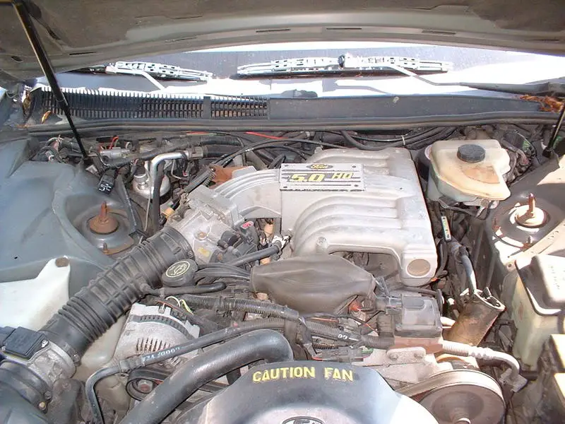

I have a 1992 Thunderbird with a 5.0 HO and AOD with about 80,000 miles on it. What does this engine share with the 5.0 in my early 1997 Explorer? Mainly the block and heads, are they swappable? I need to decide if I want to hold onto this for future use, possibly a stroker motor or something.
Here is the engine...

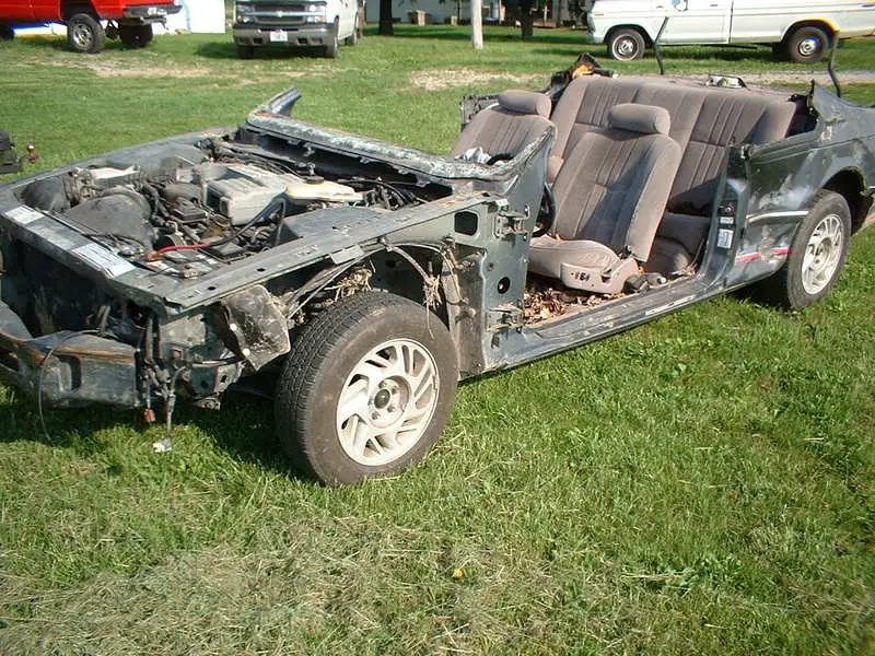

And for fun, here is the car. It's in storage now, but I'll be getting it back out in spring...
The ultimate convertible...
-Short Block is the same.
-Cam is different.
-Heads will interchange, but are better on the Explorer.
-Intake is better on the explorer, along with the EFI system.
-Front accessories are different on the Explorer.
-Explorer does not have a distributor.
I'd save it, rebuild it, and then use your explorer front accessories, intake and efi system
-Cam is different.
Excellent information, thank you! The block and it's internals were the main items I was curious about, and wether or not my current heads and accories would bolt to the older block.
