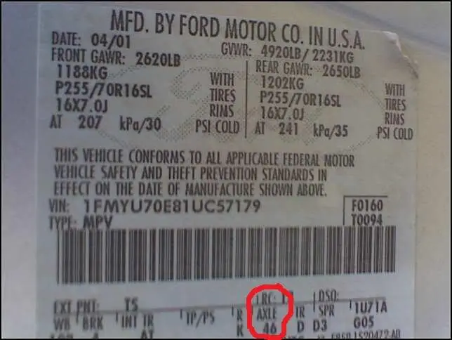

It isn't necessarily 4.10s or 3.73s... Take a look at your driver side door jamb and see what the axle code is...

mine says D4 What is that?

D4 is a limited slip 3.73

There is no way to directly ascertain the axle ratio from the VIN. Any dealership (or those with access to as-built data) can enter the VIN into the system and find out what it was built with. The axle code is also on the door sticker inside the driver's side door jamb.
