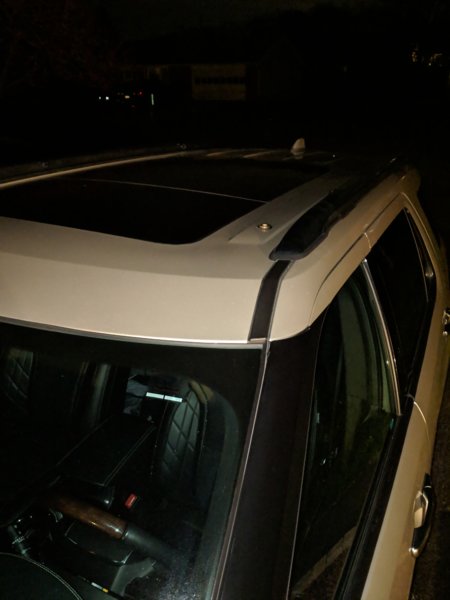

Hi I am new to the explorer community and just purchased a used 2017 explorer platinum today. For the life of me I can not figure out what this thing is on the roof. It is threaded so something should obviously be screwed on to it but I am not sure if this is something someone added aftermarket or if this is stock. It sits near the top of the roof rail above the driver door. I was thinking something to do with park assist as I do get a little error when I go in reverse with a picture of a car with a red exclamation in the middle of it. Any help would be much appreciated. My googling so far has not returned much results.
Hi I am new to the explorer community and just purchased a used 2017 explorer platinum today. For the life of me I can not figure out what this thing is on the roof. It is threaded so something should obviously be screwed on to it but I am not sure if this is something someone added aftermarket or if this is stock. It sits near the top of the roof rail above the driver door. I was thinking something to do with park assist as I do get a little error when I go in reverse with a picture of a car with a red exclamation in the middle of it. Any help would be much appreciated. My googling so far has not returned much results. View attachment 169784
Would you happen to have a photo of the surrounding area? I've never seen such a device. Where on the roof is it located?
Here is another picture. Sorry the lighting is not great. It sits between the sunroof and the roof rail.

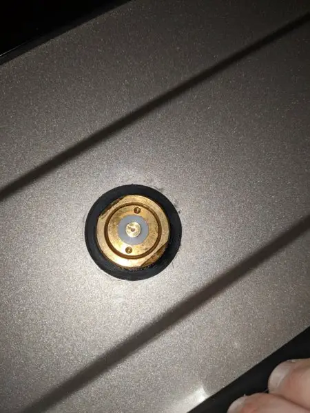

Looks exactly like the hard mount for the CB radio antenna I used to have.
Thanks guys much appreciated. Time to find out where the other end of it goes :)
Look up "Motorola NMO"
It should come out somewhere in the under dash area, most common spot for a CB. Somewhere within reach of the driver. Or possibly the center console...
That is an NMO mount for a ham radio antenna.
It required a 3/4 inch hole to be drilled thru the roof for the bottom clamping device.
The last vehicle I had my rig mounted in was the Highlander. I used mag mounts and ran the lead in through the tailgate.
Peter
Good news is: If you wanted an antenna mounted on your roof it's a good NMO antenna mount and will give you great reception.
Bad news is: Someone drilled a 3/4" hole in the roof of your vehicle and one day it possibly could leak.
