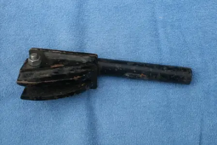

Down here we've got an attachment for high lifts that fit the normal jacking points of the truck. I'll see if I can find it so you can have a squiz.
