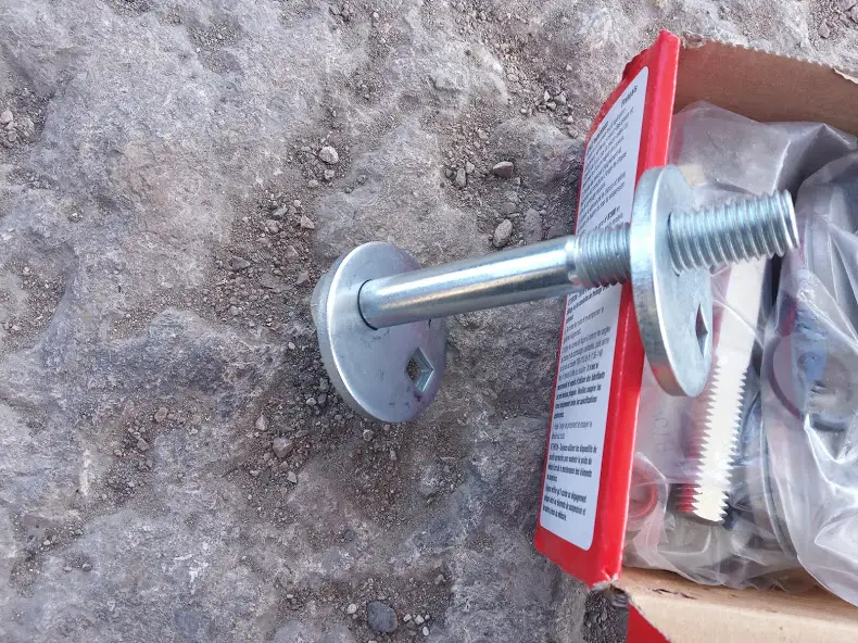

Basically every front end suspension component affects the alignment. On my '96 the main adjustments happen with tie rod ends and the control arms, which are adjusted with camber bolts. If you're worried about stuff "going bad" have your BF look at it first when he has time- but the change in tie rod ends would absolutely affect the alignment unless he was out there with lasers and measuring out the toe by hand.

It’s adjusted via the camber bolts and what position the strut is in when everything is bolted together. Otherwise the only 2 other things that could be true are:
1. There is no way at all to adjust caster/camber. (There certainly is.)
2. The tie rods adjust everything in the front end. (They don’t.)

i did my 11 limited base at my work and youd need a castor kit to fix castor there isnt a spec to fix castor unless you run into a curb to pop the wheel back to zero
i cant remember about camber but youd need a camber castor kit in order to fix the castor. or just run into a curb with the one wheel thats off

special cam bushings/bolts
My understanding was Ford set the alignment at the factory with no way to adjust it afterwards. Ford house or any auto parts store has the two shims. I think it was $20 for the pair.
