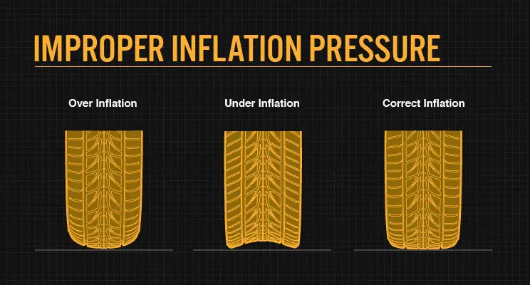

Well until recently, anything under 45 seemed low to you, right? It's just a number. What you want is for the full width of the tire to make contact with the road. Whatever pressure that it takes to accomplish that is the right pressure.

I am running about 42 psi in my 31x10.5 15 BFG ATs and I get full contact , but every tire is different so what I do is air them up to about 45 then place a framing square across the tread and air down till its square , sounds silly but it works

The "best" pressure to run in a particular tire size depends a lot on the vehicle and the load on the axle the tires are on.
Whatever pressures give even wear across the tread is the "correct" pressure to run a tire at.
There's really a range of pressure you can be within and still get even wear, so the low end gives a softer sidewall and smoother ride, the high end gives a firmer sidewall and stiffer ride.
45-50psi is probably too high for daily driving, since that's close to the maximum pressure, which is what you would use if the tire was fully loaded, such as stuffing the vehicle to max capacity or towing a trailer.
35psi should be a much better pressure, but keep an eye on the tread. Things like cornering and alignment also affect tire wear, and just keeping a tire inflated a few more psi can be the difference between one that wears on one shoulder due to alignment/handling and one that wears evenly.
