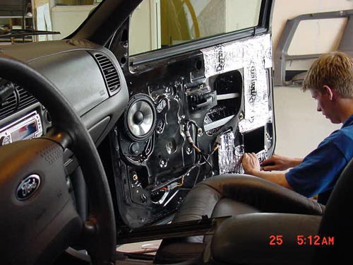

does anyone know the correct size speakers for front doors for a 2001 sport because i have seen 6x8 and 4". i could have sworn all were 6x8 also whats the depth?
the stock size uses 6X8 (5X7). but you can use 6X8 plates which have a 4" woofer and 1" tweeter. or you can install 5.25" or 6.5" speakers.
thanks for the reply. i know i can get adapter plates to fit 5.25 components but i didnt know i can fit 6.5.
6.5's may take a little trimming and muscle, and you've gotta watch the depth, but they can work.
6.5"s are no problem, Mine fit like a glove!
