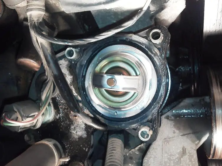

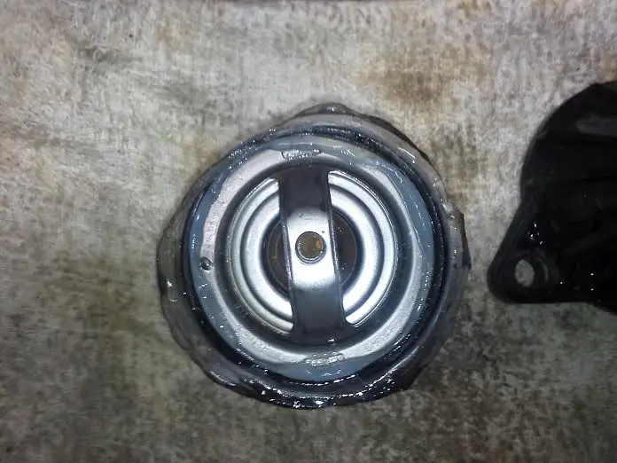

I am replacing the thermostat on a 2003 Explorer that I just recently purchased and when I took off the housing to remove the old one this is what I see?
It looks like the PO used silicone around it but why?

Thanks for the link. So you think he used this to stop a leak? If so it has worked because I have owned this for about 3 months and have not had any problems leaking coolant?
How would the silicone stop a leak in the lower housing?
Also does anyone know how to position the thermostat bleed hole when I install the new one?

The lower housing splits at the seams. By far the most common failure in the 4.0L SOHC cooling system. Your first pic shows coolant residue on top of the housing caused by this. Read the link provided and search the forum, extremely common failure.
OK, thanks for the information.
Rangerman
The "bleed" holes orientation on this vehicle wouldn't appear to matter. You want it on top usually.
