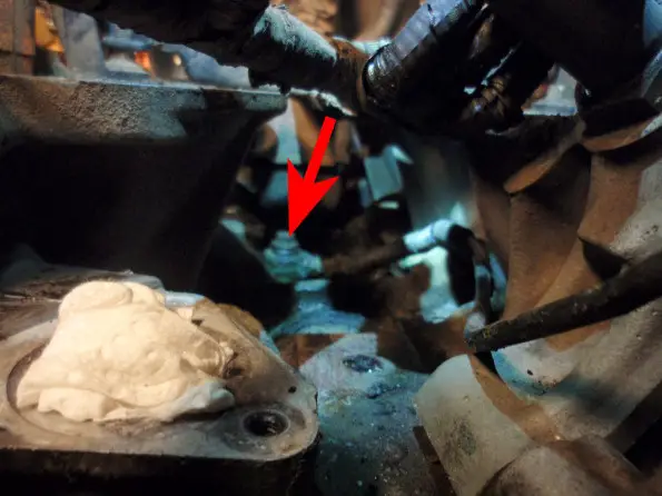

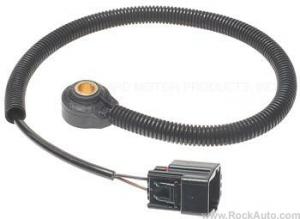

The knock sensor similar to the one installed on my 2000 is shown below. It's mounted low in the valley between the heads.
Do the photos look like what you're referring to?
