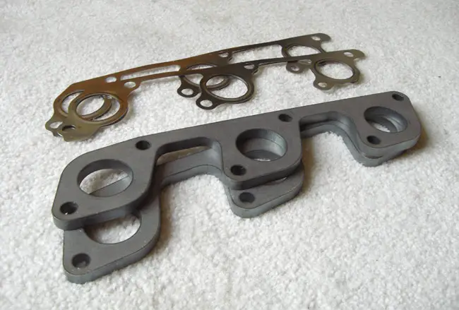

For one thing, the exhaust lobes/bolt pattern on the heads are different (between the two blocks) because I had to send the guy a new set of gaskets to trace from in order to laser cut some header flanges.
Well crap, that sucks =[ Are you making some 98-01 headers IZ?
Yeah but its for the SOHC and wont be compatible with the stock exhaust cauz it crosses over on top of the trans (as opposed to running under on the stock SOHC and OHV config).
