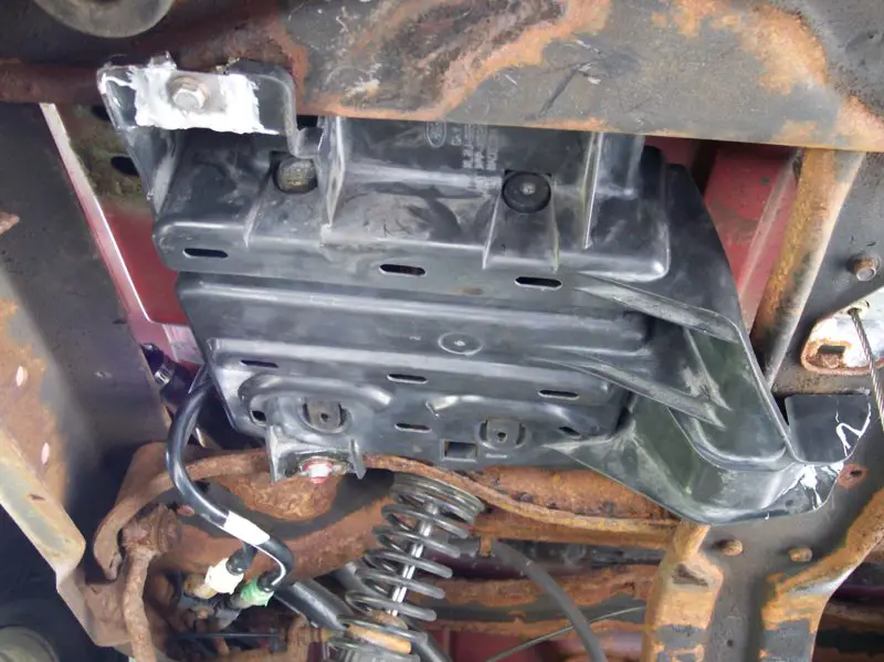

Cover for the evap canister? They became plastic in the later years.
This?
Not really. What is the part you show? Beginning to think, it's simply part of the floor pan under the cargo area. Hope to get a pic of it tomorrow. The odd part is beneath the thin, rusted out metal, is a shiny pad that looks like it's insulated with foil-like material. Thanks for taking the time with my mystery part!
That’s typically covered mostly by the spare and is often rusty metal. It’s the evap tray, which I’m pretty sure is what you’re talking about.
It is flat like that. Guess I need a new evap tray. O'Reilly's scan did show a code for evap a while ago, thought it was for my gas cap which fits loosely.
