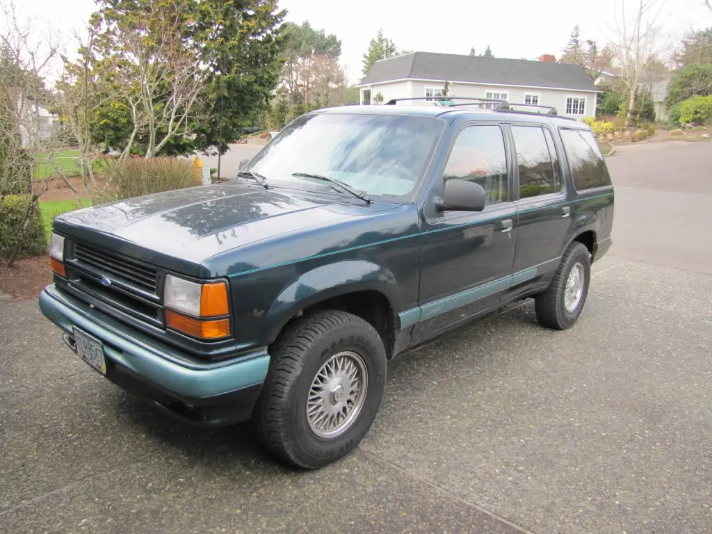

Ok so sorry first of all I have not been posting in while been a little busy haha. But I have spent some time doing some extensive research and I have decided to start from the bottom and work my way up.
I'm thinking of getting some 33"/12.50 (Maybe not 12.50's I need to look up the advantages and disadvantages of wider tires) but tires on some 15X8 wheels just some cheap wheels and I'm still researching some tires.
Also I am thinking of getting some spacers (any suggestions I don't know much about spacers so any information is better than none) and then also I going to get my new gears 4.56.
This will get a good start going so I am still being able to drive my car around and can research more on the lift I want to get. Also I have started too collect gear do you guys have any suggestions for cb or ham radios?
BTW I don't know if it's the same around everyone else's area but does everyone you see with a lifted vehicle have these wheels? and any reason they might? other than super cheap price.

Alright, on the tires, my suggestion would be to stick to 10.50 if you can. A wider tire is going to rub your radius arm at full steering lock with the size lift you're looking at. I would personally stick with the 10.50s.
As far as wheel spacers, do you just want them because wide tires that stick out look cool? Cause I'm not gonna lie I love that look. However after looking into spacers I wouldn't do them. Get a rim with smaller backspacing (like 3.5") and the wheel will stick out more.
Spacers move the tire further away from the suspension and put more stress on all the components. Think about holding a dumbbell in your arm at shoulder level. Now think about how much extra weight it feels like as you move your arm away from your body. If you hold one with your arm completely extended it really wears on you. It's the same with your suspension. The further the wheel is out from hub the more stress you put on parts.
4.56 will be a good choice. It seems like you're getting a good plan laid out for your build.
As far as CBs dad and I have always run Cobras and always liked them but I've still managed to blow up 2 somehow lol. If you like a lot of lights in your cab look at the Cobra Nightwatch series. Lights up like a christmas tree :). Makes you feel like you have a ****pit :D
Far as those wheels, I think a lot of guys just like a cheap, reliable wheel. You can't really go wrong with a painted steel wheel like that.
