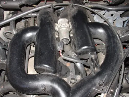

Can someone please tell me where the IAC valve is located on a 2002 Expl 4.0. I know what one is supposed to look like but am having a hard time pinpointing it in my engine compartment. A pic would be great.

Try this pic, it's from a 91-99 so it may not be what you need. Just a try for ya. I couldn't find one for a 00+
The IAC is the silver device on top of the intake. This is a SOHC motor.

Found it. Gave it a good cleaning. Engine's idling fine now. Thanks for your help.
