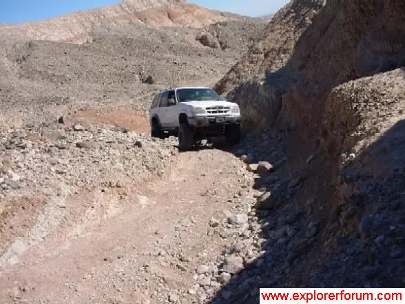

I went with a 3"BL but I know when I do my SAS that will be too much and I'll probably go down to a 2"BL. If you are going to do 4" Suspension lift, then depending on what size tires you want to run and how much trimming you want to do then choose your BL accordingly. The TT/Warrior Shackle lift is the best because you can still keep it if you decide to go with the Superlift. My truck is just one of the MANY lifted 2 Gen Explorers on the site. Take alittle time and see what you like. There are a few options available. Good luck wheel safe!:cool:
