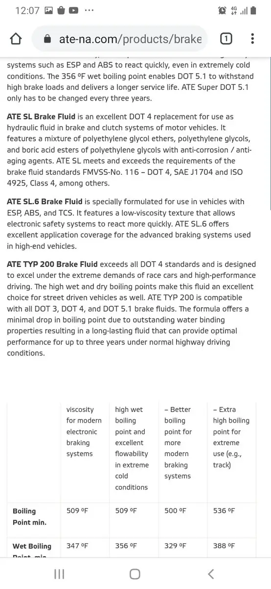

ATE site claims that DOT4 fluid fits DOT3 specs too:
Can you please specify what polymer seal material degrates with boric acid?

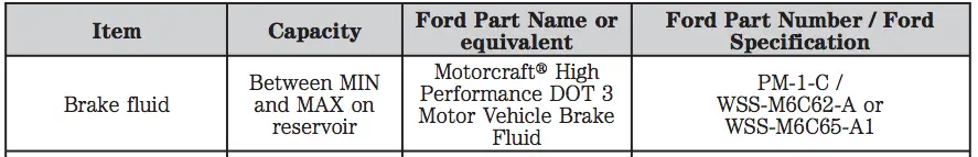

Hi Don, I liked your response and it seems logical. I am not using DOT 5 in my Dad's 96 Explorer. The manual called out DOT 3. I have though pushed the pistons back all the way taking special care not to damage the rubber boots. If no one has added fluid to the system it all going back to the master cylinder reservoir. When I get all the brakes finished, I have my wife pump the pedal with all the bleed valves open while I keep an eye on the reservoir level. I have her stop with the pedal completely depressed while I check the fluid in the clear hoses I attached to the bleed valves. I use a 10mm hose. When all the fluid is running clear I shut the bleed valves down one at a time starting with the driver front. I make sure to keep the reservoir full and the pedal down when I close them off. I then go the the passenger front, then driver rear and finally the passenger rear. I then feel the pedal for stiffness. Usually it is rock steady. I have never experienced any issues doing this but, then again I have not seen where it says I shouldn't back flow the ABS system. My thought is that due to the brake system being a dead ended single acting hydraulic system, the fluid never gets exchanged with new fluid when you applied the brakes. Therefore you get a build up of wear particulate in the lines and pistons. With that being the case I have to assume that the "McPherson Curve" applies to the wear factor. Look it up online. www.filtermagindustrial.com It is very interesting and I have actually seen this in many hydraulic systems. I design hydraulic and control systems for my company and I make sure that I do not end up with an area of the system that the fluid does not get exchanged. If the fluid does not get exchanged we end up seeing premature seal wear in the actuators. Let me know if there is something that I could damage by flushing the brake system about once a year or so. I would be interested so that I am not going to mess something up. Thanks! FATK

Very interesting. On the one bottle that I had it said DOT 3-4 and it said it could be used in a DOT 3 or DOT 4 system. I sure hope I don't have a problem. At least most of it is DOT 3.

According to updated FMVSS brake systems (not the clutch systems)practice, brake fluids made from the same chemical base (including any kind of additives) wont harm any seals,hoses,metals or other brake system component.
Vehicle made in 1994 probably used an old type of seals degrated from DOT4 brake systems additives or FMVSS practice claims something else about clutch systems.
Anyways.Cars made after 2000 shouldt have any problem with mixing between DOT3 or 4 since it is the same seals used in both brake systems
