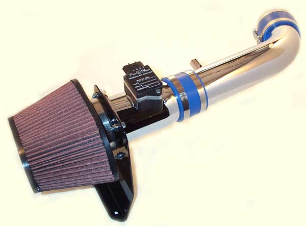

All of the Mac Systems are CARB approved and come with the sticker. We have the Mac in stock for V6 OHV (96->) V6 SOHC, V8 5.0 & V8 4.6.
The V8 5.0 #3659 $134.95 (CARB E.O. #D-241-5) in stock at Explorer Express.
(#3606 shown with the Pro-M 75mm Mass Air Sensor)

wooh. John, that's cherry lookin'!

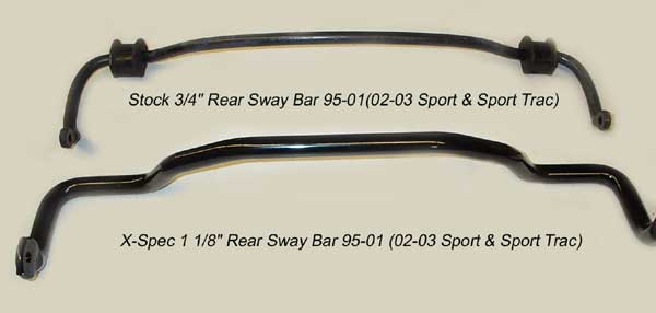

Do you have our rear sway bar upgrade yet? It is by far one of the best upgrades for any Explorer, especialy a Sport. It is inexpensive and easy to install.

Hey John. I am really considering your swaybar. I love the whole x-spec package. How much for the sway? In no particular order my next 3 are chip, exhaust and, sway.
The X-Spec Rear Sway Bar ZD5622 is $179.95. If we get enough interest we can get a group buy going. It is by far one of the best upgrades you can do to an Explorer.
This picture shows the difference between our bar & the stock bar.
