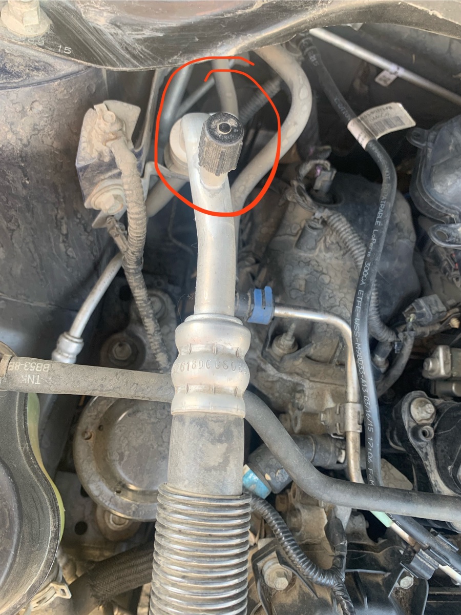

Those are not ports for the fuel system! They are the high and low access fittings for the A/C system.

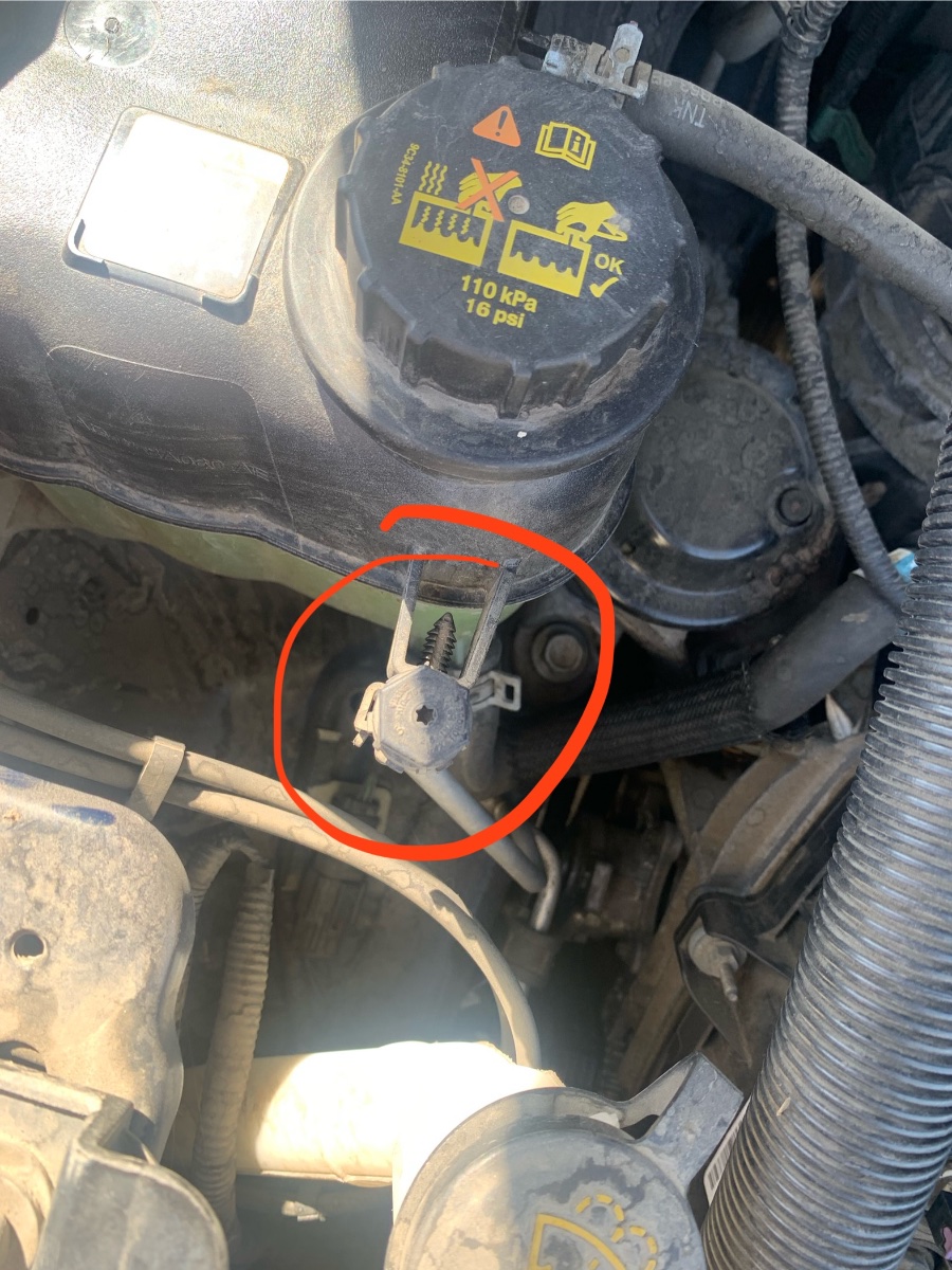

I am fairly certain there is no mechanical connection on a 3.7 to test fuel pressure it must be read from a scan tool. The metal fuel line is the one with black/blue plastic connector in second picture and goes around front of engine to fuel rail.
No ports for fuel testing as stated above
