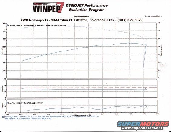

My second to last build dyno sheet:
That's a good looking power curve, poor picture but good curve. What are those power adders, the CI, heads, and compression?
That "build" actually was a stock 1996 351W roller engine with 10lbs of boost from a Kenne Bell Blowzilla. I ran a 90mm Lightning MAF with larger injectors and my Tweecer tune.
