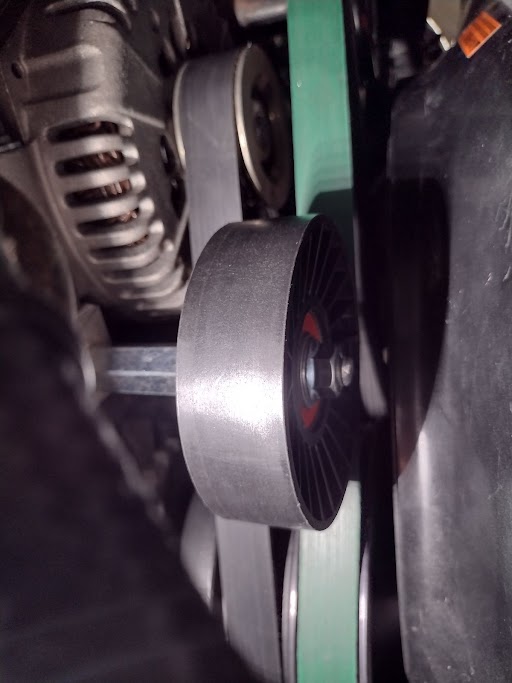

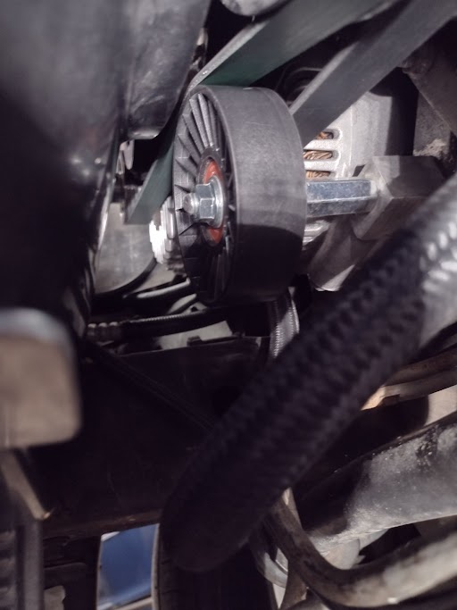

So we came up with this with Powerdyne. Coming off of the lower alternator bracket we put an idler pulley that basically puts pressure on the bottom of the supercharger belt and then tensioned it to the appropriate tension measured using Gates KriKit tool
