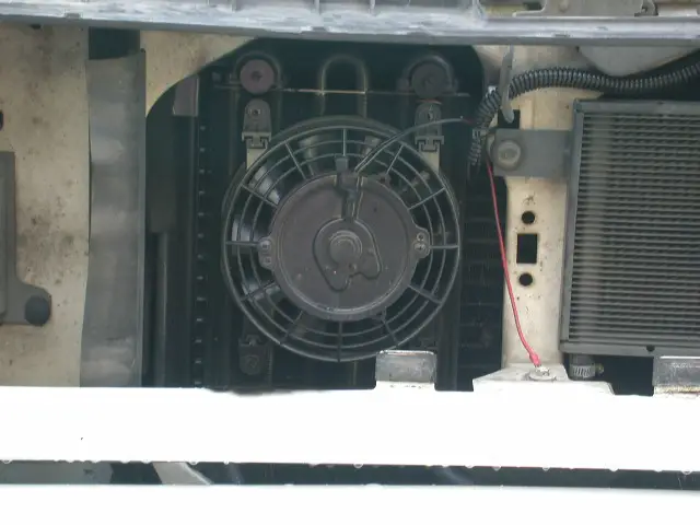

The radiator cooler is only "kind of" a cooler. It "cools" the trans fluid to the temp of the RADIATOR! Nice... on a cold day.... but an external cooler is the only way to go on a warm day. The Explorer towing package had one.... so should you. Even aftermarket.... and after radiator.
So if we have all that..... well... here is the worst case.... freeway rush hour stop and go.... 5 mph and stop, lather rinse and repeat.... no airflow over the radiator or aftermarket one either... no lockup.... HOT. (Does this also sound like off road?)
All other kind of "hot" has a problem lurking somewhere.
IDEAL ? Aftermarket cooler with dedicated electric fan. Essential for normal use? No. Nice.... uh huh. Offroad? Maybe past being "just a good idea".
There ya have my take on it.

where did you get that setup Albino...i need one, as my wheeling habits have begun to take a toll on my tranny i believe.
Now that's exactly what I am talking about! Sweet.
yeah Glaicer you are on my page.

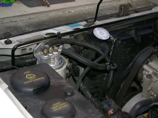

Spindle, I have the Perma-Cool filter with the temp sender in the filter mount. It is the first to see the tranny fluid on its way out from the tranny on its way to the coolers.
Like this, right Kevin?
slravene, that's a Flexalite 4190 $153 from Summit. I went with the switch instead of thermostatic control in case I am in deep water, I don't want it to come on and bend up the blades trying to push water.

I put my temp sender in the place that made the most sence to me. For sake of ease the options were limited. Before or after all the coolers. No brainer right ?
It is usually with in 5 to 7 degresse of the ECM. Guage to the hot side. Close enough for me.
