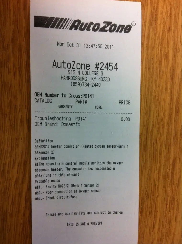

- P0141 code says the heater circuit is bad for the Bank 1, Sensor 2 O2 sensor. This will be the rear one on the passenger side. Usually it's the sensor itself that is bad; other possibiltiy is a break in the wiring harness to the sensor.

yeah i figured out today that there is supposed to be a sensor there. i dont even have any pipe after the catalytic converter so it makes sense as to why that code is coming up.

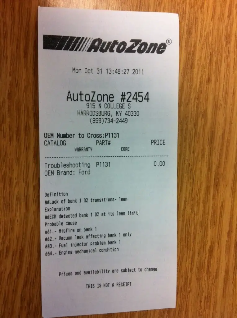

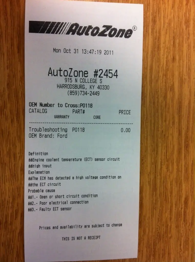

so today i took the truck back over to auto zone today at lunch. the only code that is still up after replacing the CTS is p1131 (minus the #2 o2 sensor...). any ideas on how to fix it??
