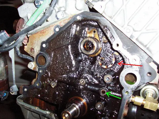

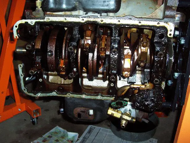

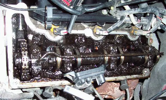

Coolant flows thru the heads (and block) whether the thermostat is open or closed. The closed thermostat blocks flow to the radiator allowing the engine to warm up faster. When the engine is driven a lot at below normal operating temperature sludge rapidly forms.
Once it forms it is difficult to get rid of and if not done carefully can block oil passages when large chunks break free.
Wow! thanks for those pics, that's a great argument for never running sans thermostat.
