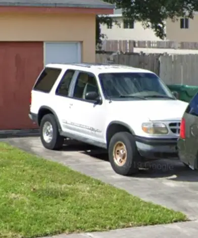

your 97 sport came with a sohc engine in what 2000? Fitting the SOHC engine is a bolt in deal, although you will have some choices to make What computer to run, you would want to convert to returnless fuel like all other 98+ ford SOHC vehicles, again that all bolts in.

with the two vehicles sitting next to each other it is rather straight forward to put the drivetrain from any 95-2005 RBV into that 97 2 door
Just know what you are getting into..... before you get too far into it
