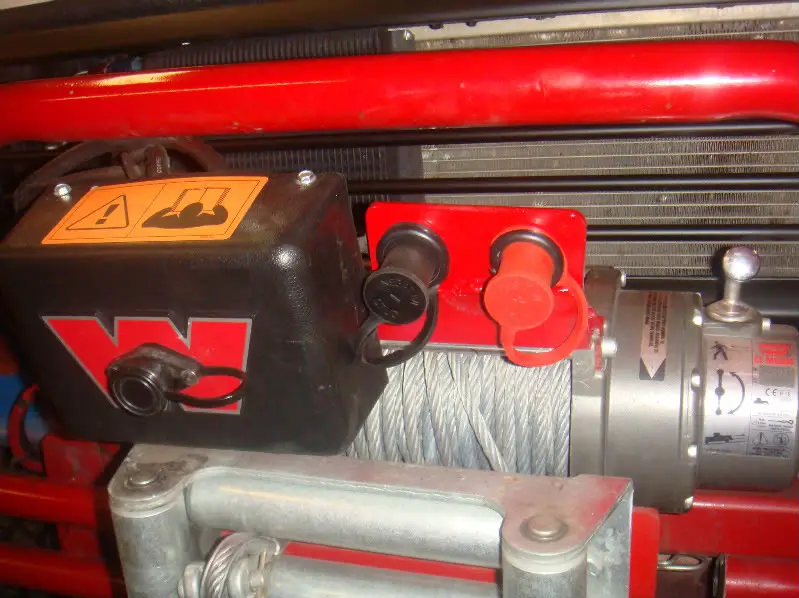

Hope some of these ideas work for you. I also added remote battery terminals to the winch. They stay with the winch whether it's in the front or back.

Here you can see another pull pin but more importantly you can see the quick disconnect for power. One of these is also at the rear bumper that has another receiver mount.
