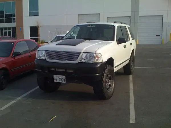

i cant wait to get back. if 86explorers86 setup isnt done ill have 3 months payed leave to "fix" my truck and get her up in the air
are you saying that you are going to go on an independent rout not using the system i create
your setup is my first choice but if it doesnt follow through then ill find another way to lift it
trust me im not gona let me truck look like this
