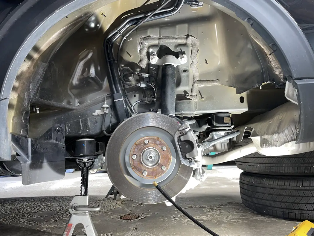

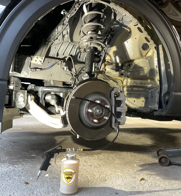

I was able to apply Woolwax to our new Explorer before we see any salt on our Indiana roads. All fender liners removed to get into the inner cavities.
I found the long tube with the single center outlet was the best way to apply it. Here's the kit I used, took about 1.5 quarts total: WOOLWAX™ 4 Quarts Undercoat Kit. PRO GUN w/ wands. Thicker than Film Fluid | eBay
Front left:
Rear left:
