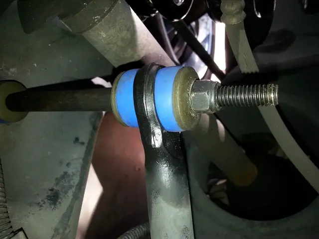

The bushings for my stabilizer were ridiculously non-existent. THIS is what they should look like but mine looked like the following. No rubber bushings on either side and the hard plastic bushings missing on drivers side. I'm kind of surprised I didn't hear clanging or loose hardware every time I hit a bump.
When I installed the new stabilizer bar links I used the torque spec of 18 ft-lbs to see how much it squeezed the rubber bushings. That torque squeezed them a little more than suggested in the video and here is how they looked.
I also used the proper torque specs for all but the strut lower arm bolt which is supposed to be 184 ft-lbs but I only went up to 150 ft-lbs as that's as high as my torque wrench went. I was lazy and did not rent a bigger torque wrench like I had on other projects. Anyhow, my 150 ft-lbs was higher than the 110 ft-lbs recommended in the video. Other than that I pretty much followed the video. I did have to stop and run out to Home Depot to pick up a 21mm deep socket as I discovered I didn't have one in my toolbox after I started the project.
