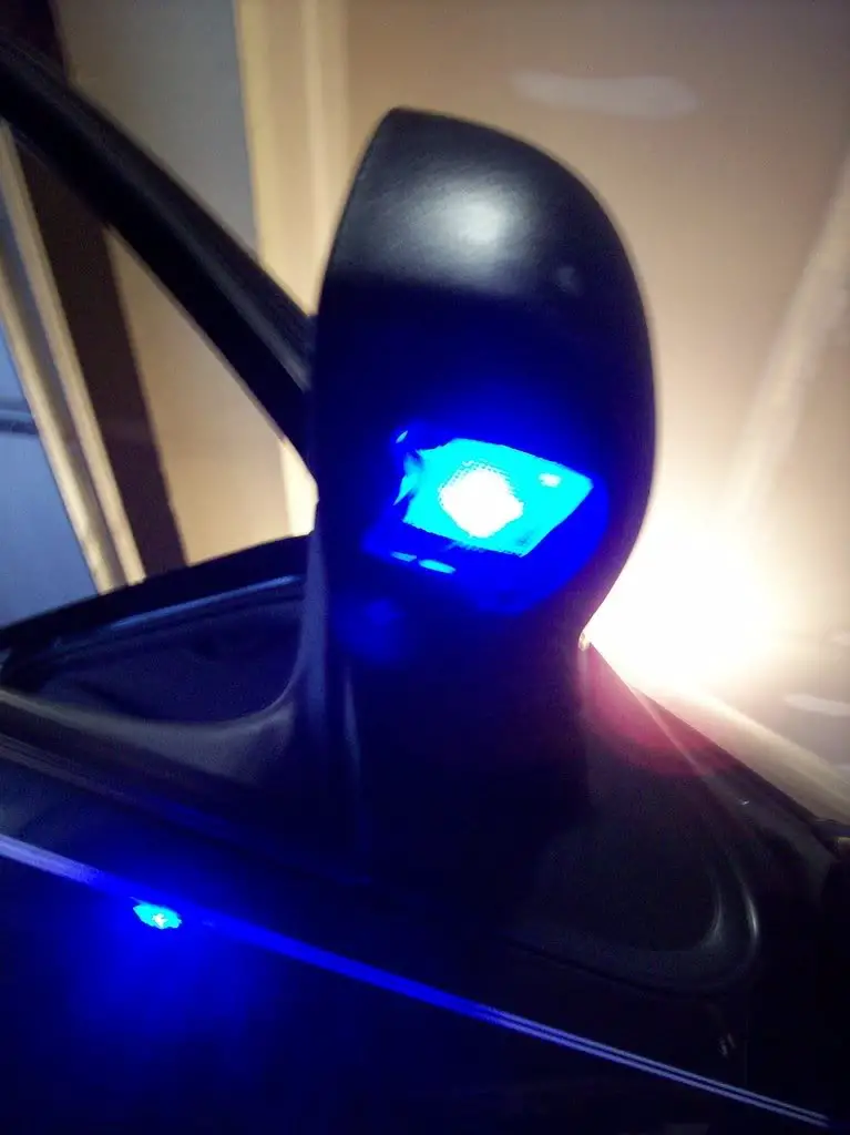

i did this a while ago but with blue lights. Made a neat little module that plugged into the orgional wiring. no cutting required. nice write up though.

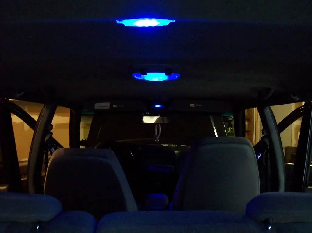

the only pic i have of the lights is this:
and then ive got this done to my truck also, everything is blue, gauges, center console, rear controols, door controlls, even the glove box is blue and lights in the vents.
