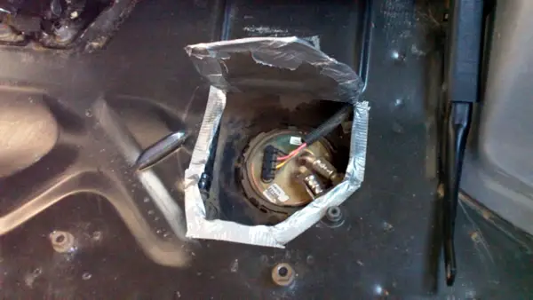

Completed this mod last night, heres a few pics, turned out real good and clean.

fyi..instead of cutting a square out and putting a new piece of metal over the hole, just cut out a horseshoe shape and bend the metal back towards the rear of the truck...
when ur done just bend/hammer it back down being careful not to bash anything underneath....i then added a light layer of foam pad for insulation and installed the plastic spacer and seat....my procedure only took a lil over an hour, and i didnt have to fabricate any kind of replacement panel...thx to whoever came up with this idea..it was great! ..zimmy
