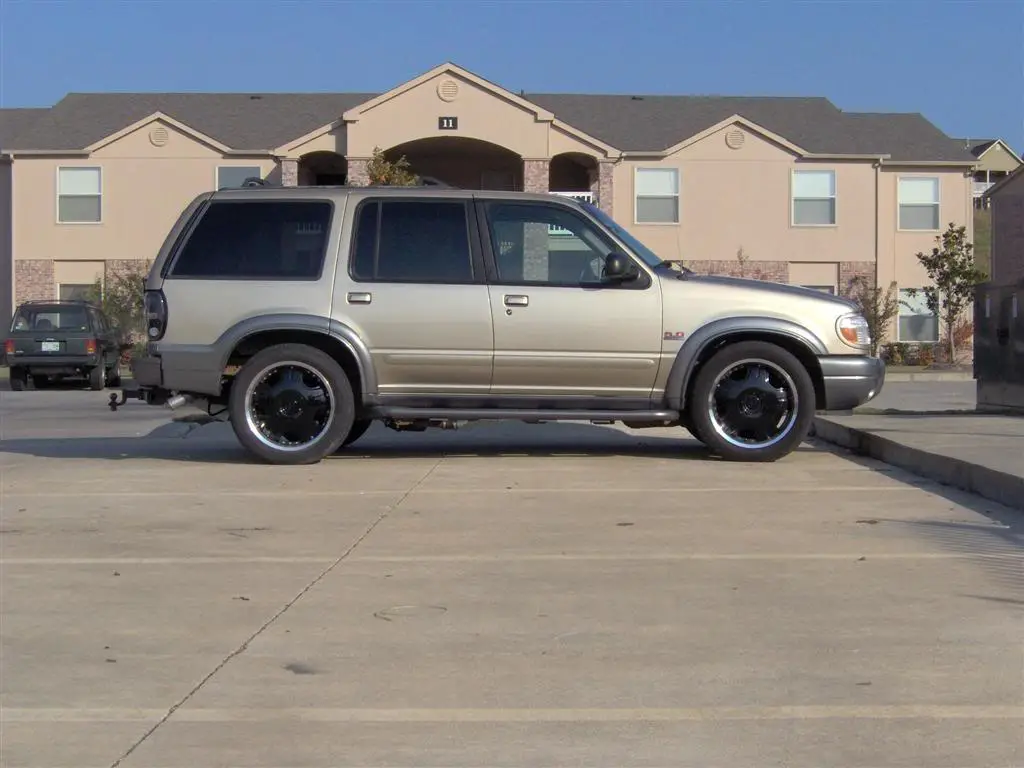

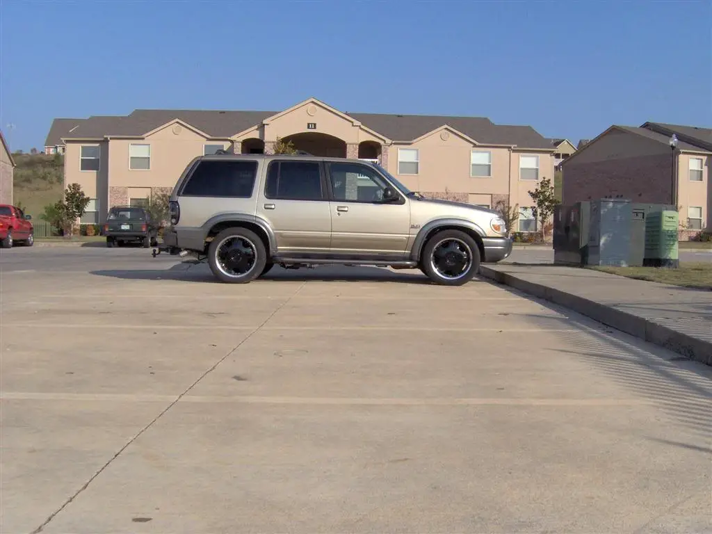

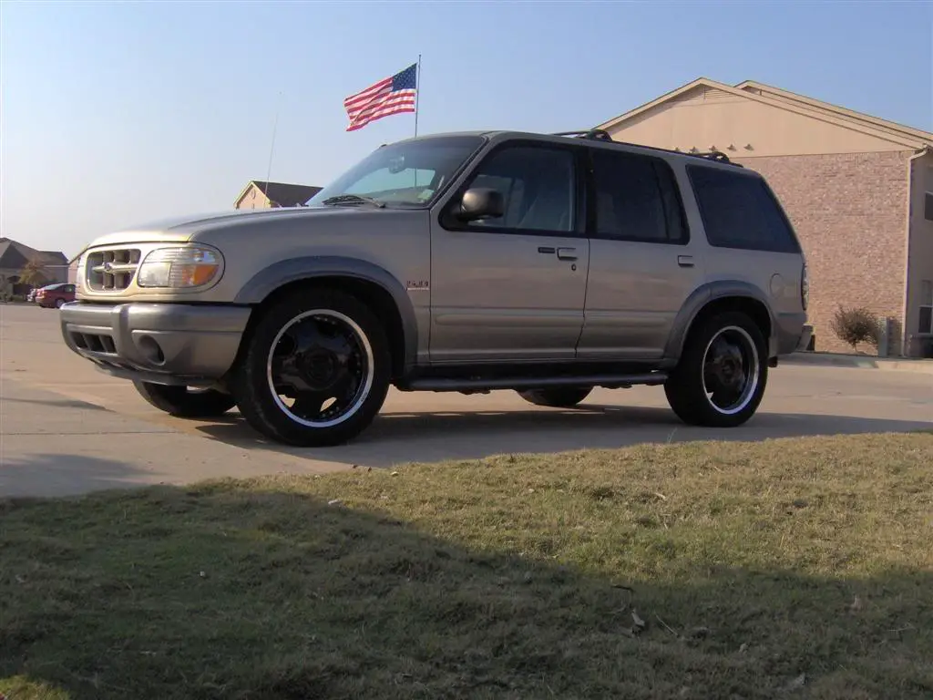

Here are some pictures, and there is a teaser video at the bottom....
