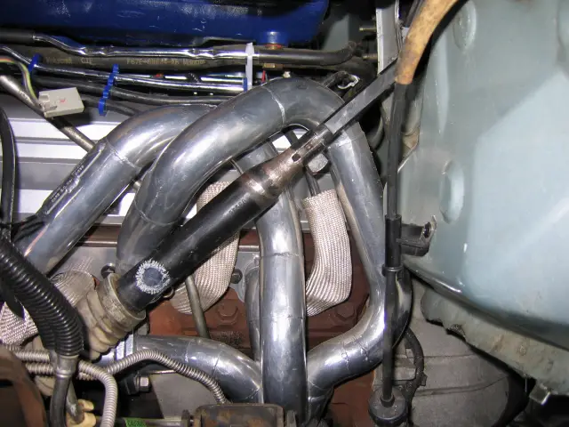

here's some pics to help:
96 explorer:
88 BII (TMH conversion headers, very similar):
I wish I had some more pics, but that should help

The wires can almost be routed in the stock position. I believe 410 is a good example of rerouting them and preventing some of the pit falls.
As far as the #3 plug goes, there's 2 ways to approach it; 1 - Use a tie-dye and pull it away from the tube by attaching it to the top of the shock. Generally, the stock length on the #3 wire is a little short... get a longer wire.; and the 2nd approach - Reroute the #3 spark plug wire to come around the back with #4. From the #3 spark plug back, there are no header tubes in the way, so come in from the back. Once again, get a longer wire!

I'm not having trouble with the plug wires themselves touching the headers, I have routed them in such a way that they are fine. The problem I am having is that when the plug wire on the #3 spark plug is installed, the spark plug boot itself rests on the manifold tube. There is hardly any clearance. I can barely even force the tip of a flat-headed screwdriver between the two. So far, the only solution I can come up with is (with heat sock installed) to shove a 1/16" piece of scrap galvanized steel between the two in hopes that it provides enough of a cushion so that I don't keep melting the boots on my spark plug wires. It cost me $28 to get a new magnecor replacement wire. I can't keep having to buy those.
