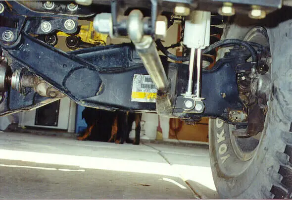

I'm pretty sure all the Zimmerman's did was use the stock radius arm and extended it with some tube and a heim. I would imagine that the Skyjackers and (maybe) Ranchos would work as well.
Pic of the Zimm.

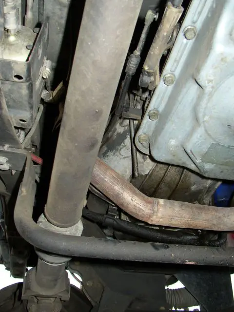

...This is the only pic I could find of my cross member and I do have limiting straps...I still flex enugh to hit it...
...I received this the other day R.J....And I know he didn't get the Heims as they are $300 more...
