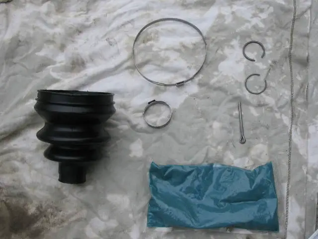

Here is the kit as it comes, with part number
Inside, you will find a boot, a thing of new grease, new metal retaining straps, 2 new metal snap retainers and a cotter pin

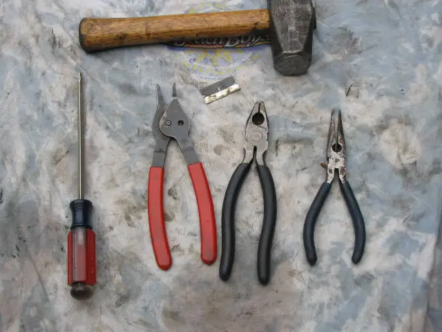

Here are the tools I used--( minus a set of side cutters)
Pair of lineman pliers
needle nose pliers
internal snap ring pliers
screw driver
hammer
razor blade for cutting the boot
also you want a grease gun loaded with good grease, and,optionally a sealed bearing grease nozzle for the grease gun

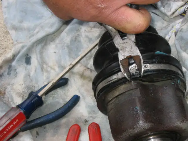

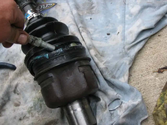

Begin by snipping prying what have you to remove the metal rings on the old boot. Don't worry, as you have new stuff. Once you have the larger ring off the end cup will slide off.

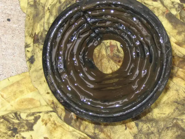

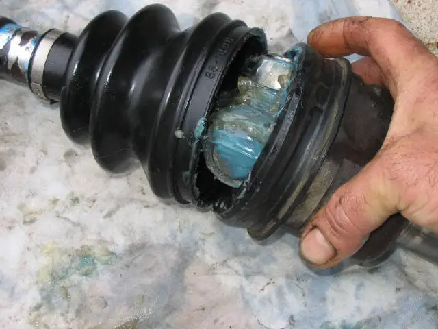

Cut the remaining boot off the shaft. Inside a torn boot you will find this choco mocha pudding, which, does not taste like choco mocha pudding at all, and, is nooo good

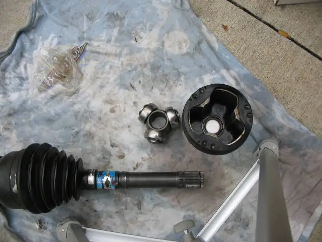

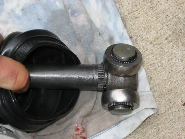

the whole mess will come apart, and look like this, but dirtier

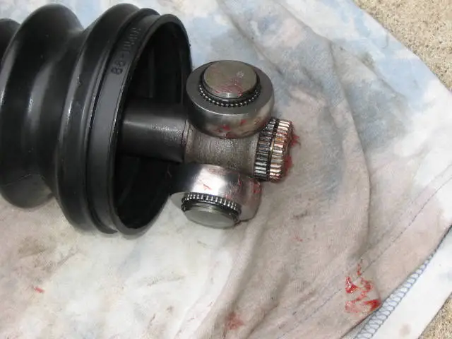

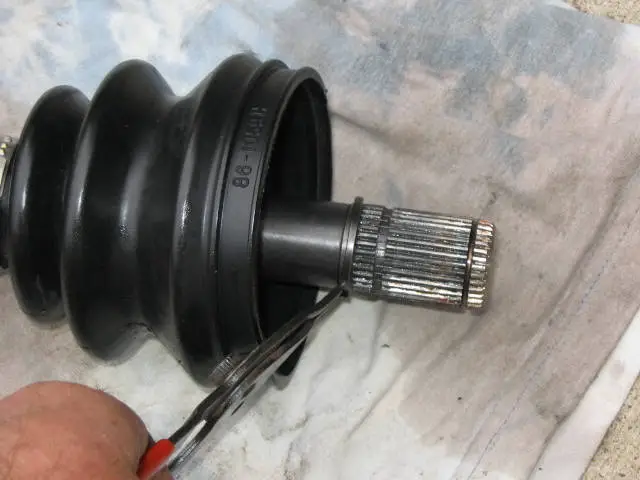

Now, look under the 3 rollers, and you will see a snap ring riding in a groove, which stops the roller assembly from sliding further on the splines

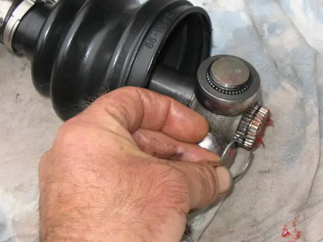

using a snap ring plier, open up the ring enough to slide it down the shaft, like this
this will allow the roller assembly to slide down like this
which will expose the smaller wire retaining ring

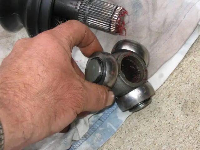

Remove the outer ring, and, slide the roller assembly off the shaft
Take note of the inner splines--the blank goes toward the end of the shaft
Clean it all up real good. I used brake cleaner, then sprayed it down with liquid lube.

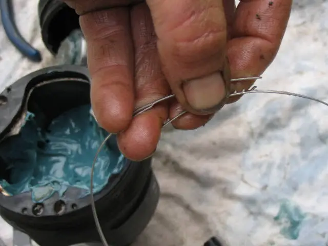

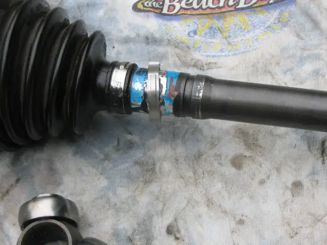

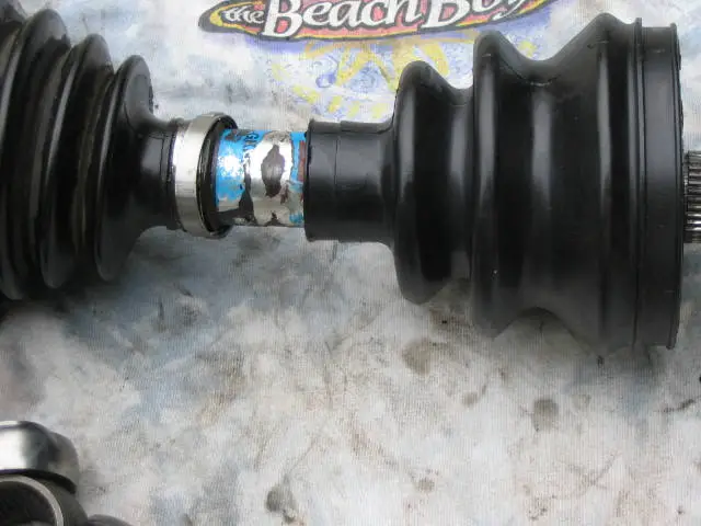

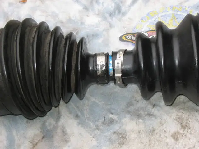

slide on the smaller retaining strap
Slide the new boot onto the shaft. it should be hard to slide. If you need some lube, use some spit,and slide it up until it "snaps" onto it's groove.
install the metal strap over it and lock it tight

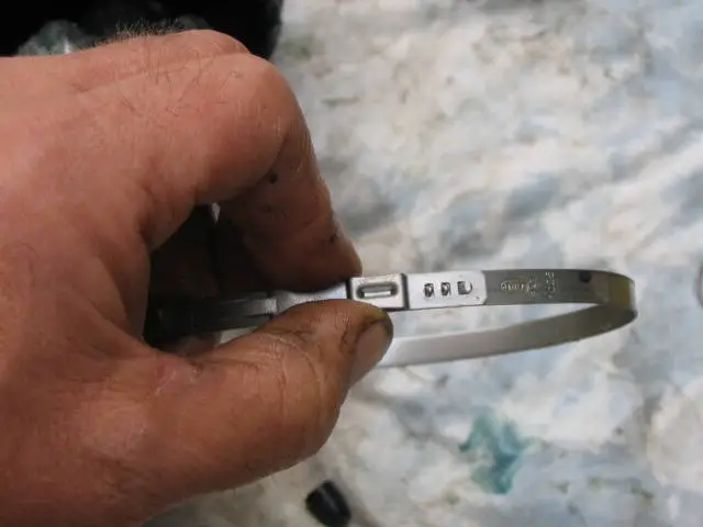

at this time let's look at the straps
they come "locked" like this
you can unlock em one handed, like this
to allow them to go over the boot, once it is in place
once you have them snapped back together, use a side cutter, and , carefully WITHOUT CUTTING pinch in on the lower portion of the bulged area like this to tighten them down. I used the hammer to tap them down flat when tightened well

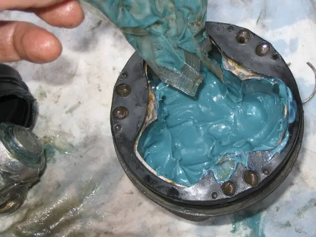

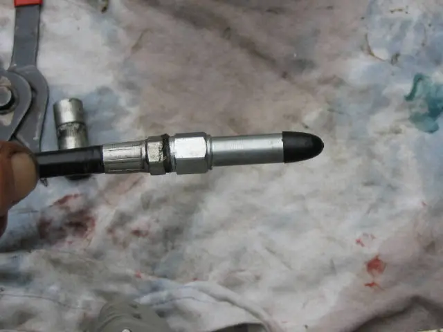

grease up all the rollers well, squirt grease in all areas with the fitting on the grease gun until you are sure there are no dry areas
now, use the supplied grease and fill up the "cup" end ,
Slide the 2 parts together
Now, Maybe I am wrong here, but I squirted in a lot more grease on top of the mess, rotating the shaft until it was all covered

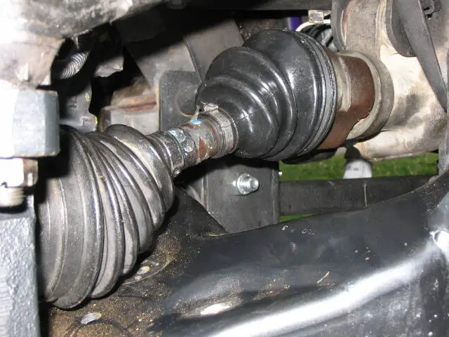

Hey Turdle, I know this post has some age, but the data is still great. I need to change the outer CV boot only. Can I remove the outer shaft of drive axle that is in the spindle after removing the CV clamp just as you had done for the inner CV boot? Or is there something more holding it into place other than the CV boot?
Thanks
The CV joint that the pictures show is the joint closest to the differential case. I have a torn boot that is closest to the spindle. From what I have read on this forum, the CV joint near the spindle can not be disassembled. Thus the entire shaft needs to be pulled out; then the CV boot near the spindle must be changed by pulling off the inner and outer boots both to get the job done. Can you confirm the boot nearest the spindle can or can't be changed without needing to pull both boots?
