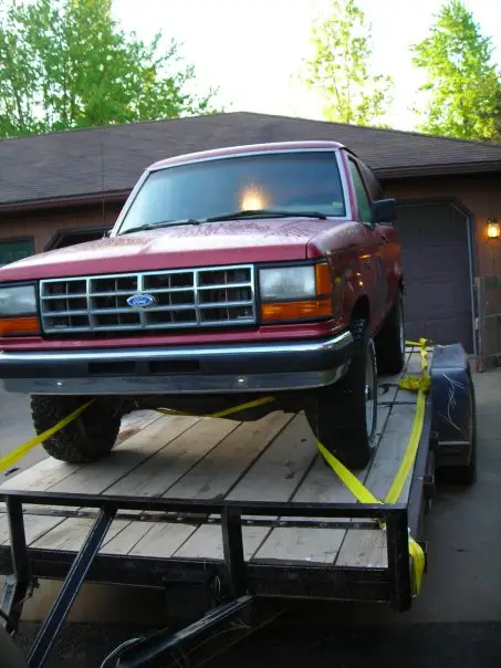

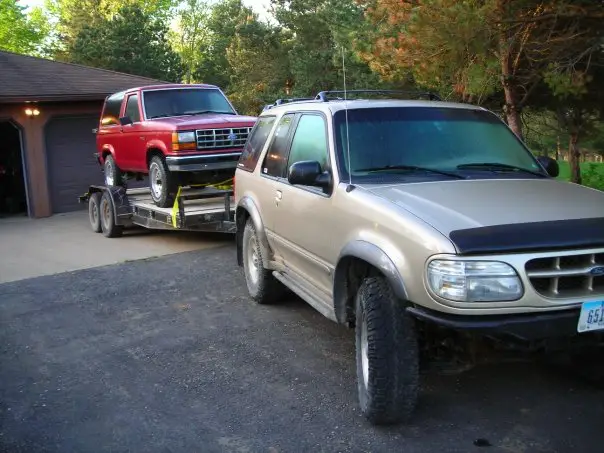

I swear, it follwed me home. Kert's B2 project

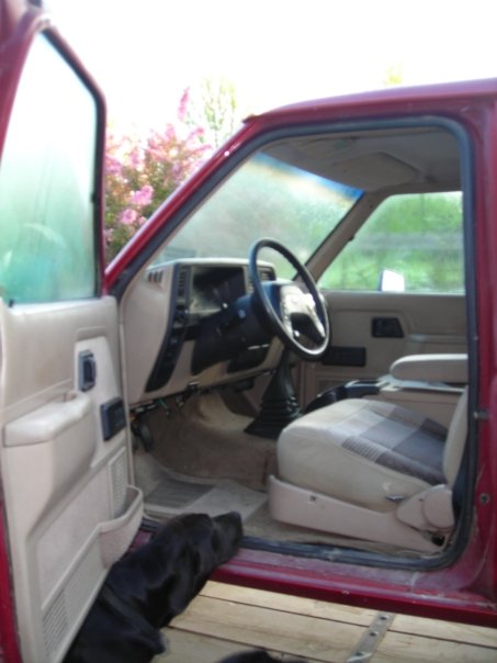

Picked up a new off-road project b2 to "save" the explorer for a couple more years.
Plan:
Rip out interior
Sell un needed parts
Rebuild engine - Swaping in a Inline 300 instead (still needs a rebuild)
bumpers/sliders
cage
Full width D60/Sterling SAS (with extended wheel base)
one-link suspension
Beadlocks
36-40 tires
EDIT: link to build album http://rides.webshots.com/album/573133941VUSlFR

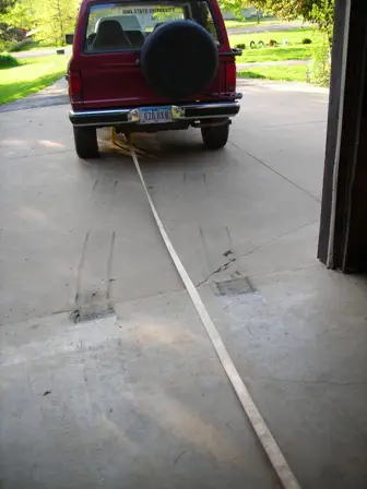

Update: Wheels, bumpers, auto hubs and maybe axles all have buyers thanks to Craig's list. Plan is to start disassembly tomorrow. Also have a lead on some D60's unfortunately I need to sell some more stuff before my wife will be "happy" with me buying them. Here are some pics of unloading the B2 off the trailer with the lawn tractor. As you can see, I almost had to add the wheel weights to it to get the traction at least with my wife on it (first time I let her ride the mower too...).

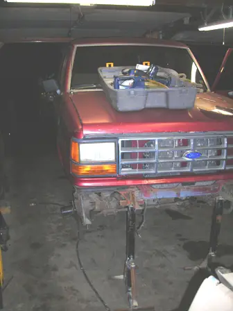

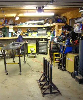

B2 jack stands ready to go. I made them the highest possible to still have functionality of the garage door with the B2 on them.

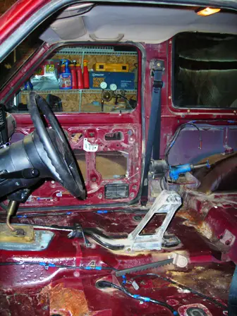

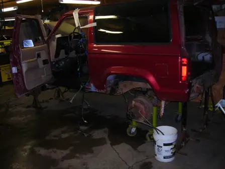

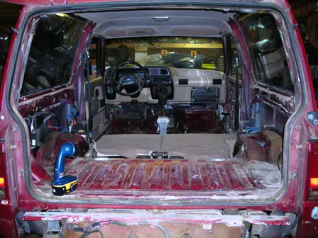

Got the interior pulled out of the B2 today. Here is a list of where mouse nests were found:
Under Drivers Seat, in glove box, under rear seats, inside rear drivers wall, air intake. Also found remains of a baby mouse in the track where main wire loom runs next to the drivers seat under the carpet...
Surprisingly the air vents seemed to be clean. Shop vac got a workout cleaning it all up though.

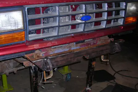

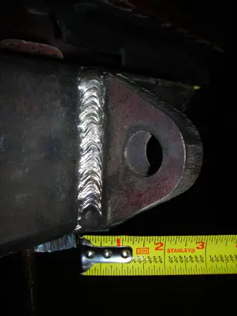

Picts of the beginnings of the front bumper and my double pass weld for the D-ring mounts.

the welds look really good!!!

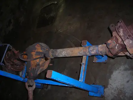

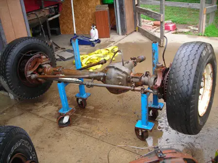

Axles
D60 Front (89 F-350 DRW)
10.25 rear
Good thing I still have these carts laying around...
edit: Realized even though the truck I got them off was SRW, the axles are set up for DRW

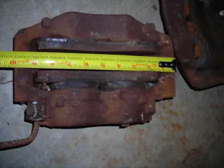

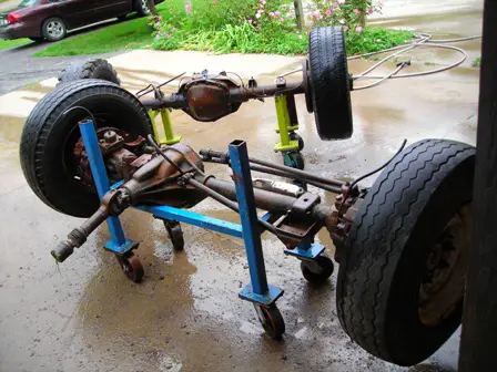

Update

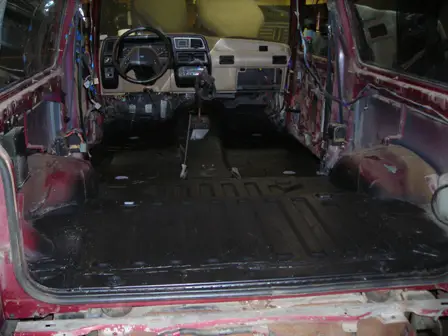

1. Interior is Bedliner'd
2. Rear suspension torn out and 10.5 stored under it for room and safety if the stands fail
3. Started disassembling the D60

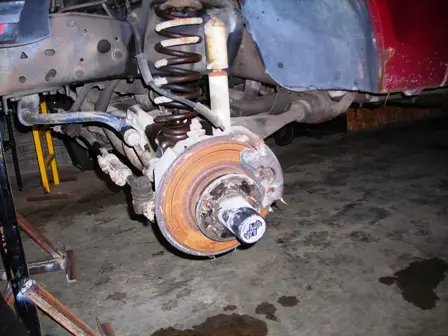

4. Massiveness of D60 calipers
