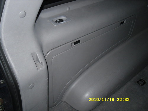

Your Interior lamp relay is likely blown. It is in Relay box #4 which is underneath the left side rear trim panel where the spare tire jack and RAP module are located. It is a micro relay of at least 10 A rating based on the upstream fuse (#27 Interior fuse panel), but I don't know the exact specifications for it. Below are pictures to help you find Relay box #4 and the Interior lamp relay. Links are provided to higher resolution images in which you can read the part numbers.
DISCLAIMER: The information given by me in this thread is for informational purposes only and should not be considered professional advice. I am not liable for any actions you may take due to them. Additionally, the information given applies only to the year 1997. It may apply to other years as well but that is not guaranteed.
1. Picture 1: Left rear trim panel with access cover in place.
2. Picture 2: Left rear trim panel with access cover removed.
3. Picture 3: Relay box #4.
4. Picture 4: Detaching Relay box #4. It is held in place by two 5.5MM bolts. You need a six inch adapter to reach them. Be careful to catch them as they fall or you can easily loose them.
5. Picture 5: Relay box #4 loose.
6. Picture 6: Relay box #4 with cover removed. The relays are shown in the picture from top left to right: Door unlock relay, Unused slot, Interior lamp relay, Door lock relay, Trailer tow park lamp relay, Driver's door unlock relay.
7. Picture 7: Relay box #4 with the Interior lamp relay removed for clarity.
Installation is the reverse of removal. I recommend only hand tightening the 5.5MM bolts as they strip easily. I was able to replicate your exact symptoms by removing my Interior lamp relay to test the function of the interior lights.
