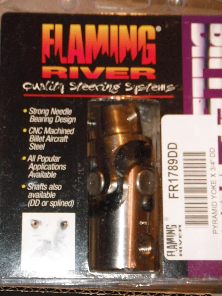

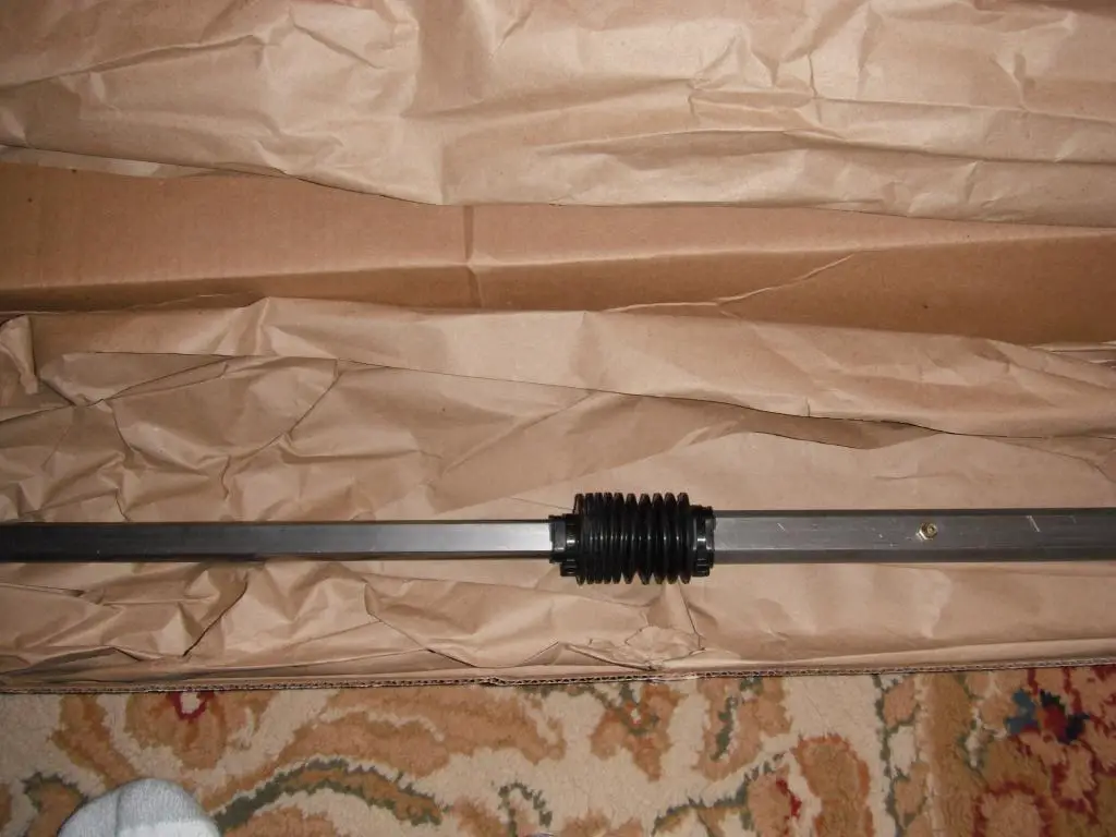

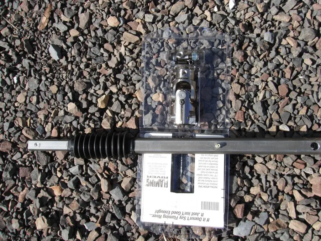

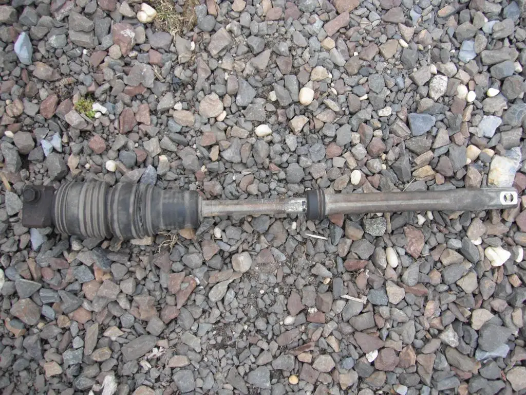

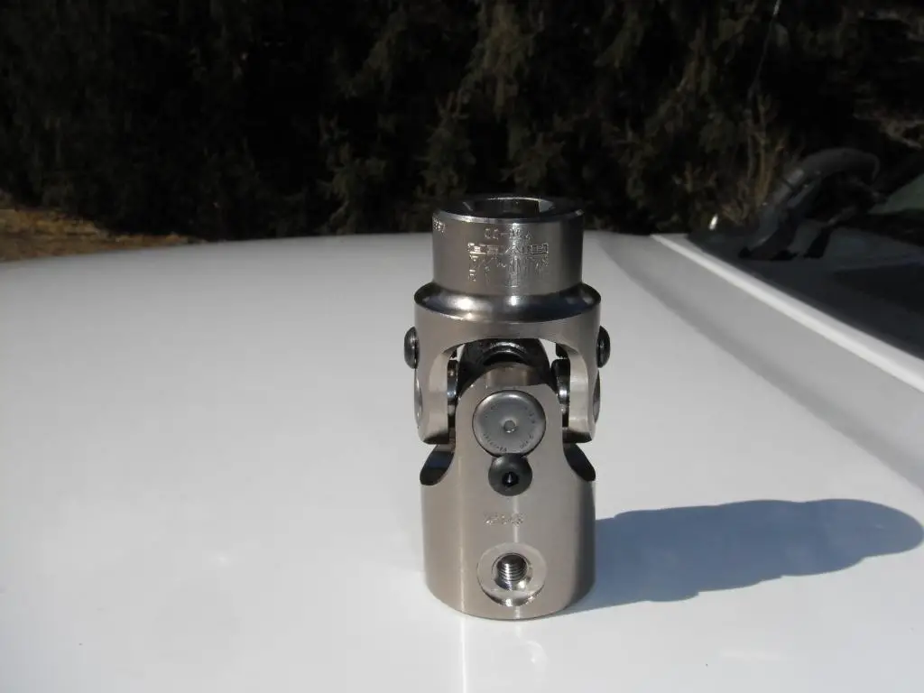

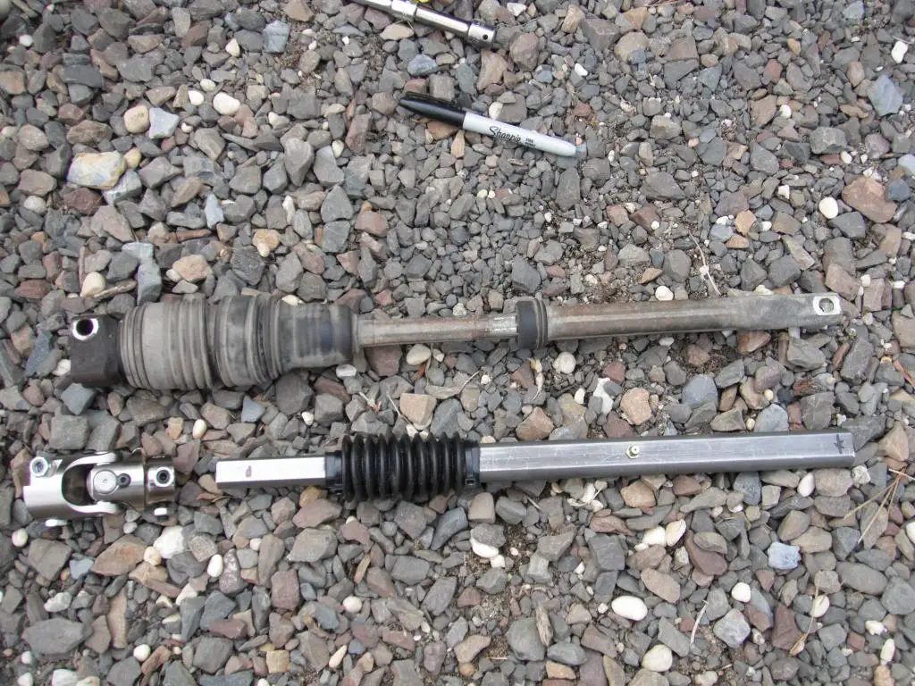

Well the plan is coming to fruition. I received my package from Flaming river today. The upgrade replaces the problematic OEM slip shaft and lower joint between the upper column and the steering rack. For anyone contemplating this job these are the part numbers that are required. FR1856-S, stainless adjustable shaft; and FR1789DD, Ford triangle yoke x 3/4" DD u-joint. Here are a few pics.
