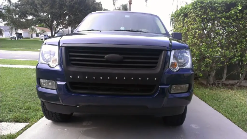

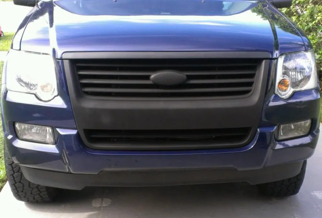

I just plasti dipped my grille. Covered the ford emblem but not sure if I should keep it or remove the plasti dip on it. Also tried some accents as you can see on pic 2 but not sure about it so I removed them for now.
Oh, and there's like a cloud effect on one of the side. If anyone has any tips (aside from do a better job next time) on how to make it less visible please let me know. Thanks!

Robby, looks good. If it were me I'd remove the dip on the emblem to give it more contrast, and I also think it looks better without the accents.

Yours looks great too, explorer0629. Thanks guys for the feedback! I ended up removing the dip off the emblem.
