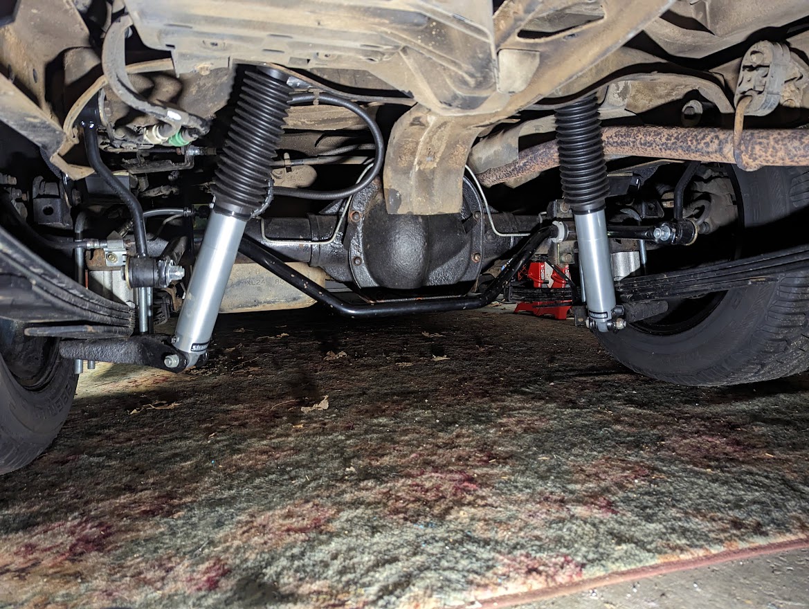

I contacted them about the fitment issues with pictures. I was going to see about bending it out. They sent me another bar that's still 1" and it fits like factory. Apparently someone with a 98 explorer sent them a factory bar to copy. Was able to use the factory links and nothing is anywhere close to rubbing. Also installed 1" greasable bushings, they need 90 degree zerks.
Id recommend calling and talking to them about getting this pattern bar if you're looking for one for a 95-01 explorer or a 01-05 ST.
