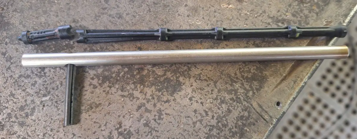

Hi guys; I have the same issue - broken plastic rod down the middle of the shifter shaft. Broke at the hole where the pin goes in (as in phil-from-tn Oct 14 post).

06bluez and phil - great help in these posts, thank you. Fabbed up the steel rod today and it is great! After spending $4 on the rod, there was enough rod left over to make 3 or 4 more. Maybe i'll put the "repair kits" on the market. :)

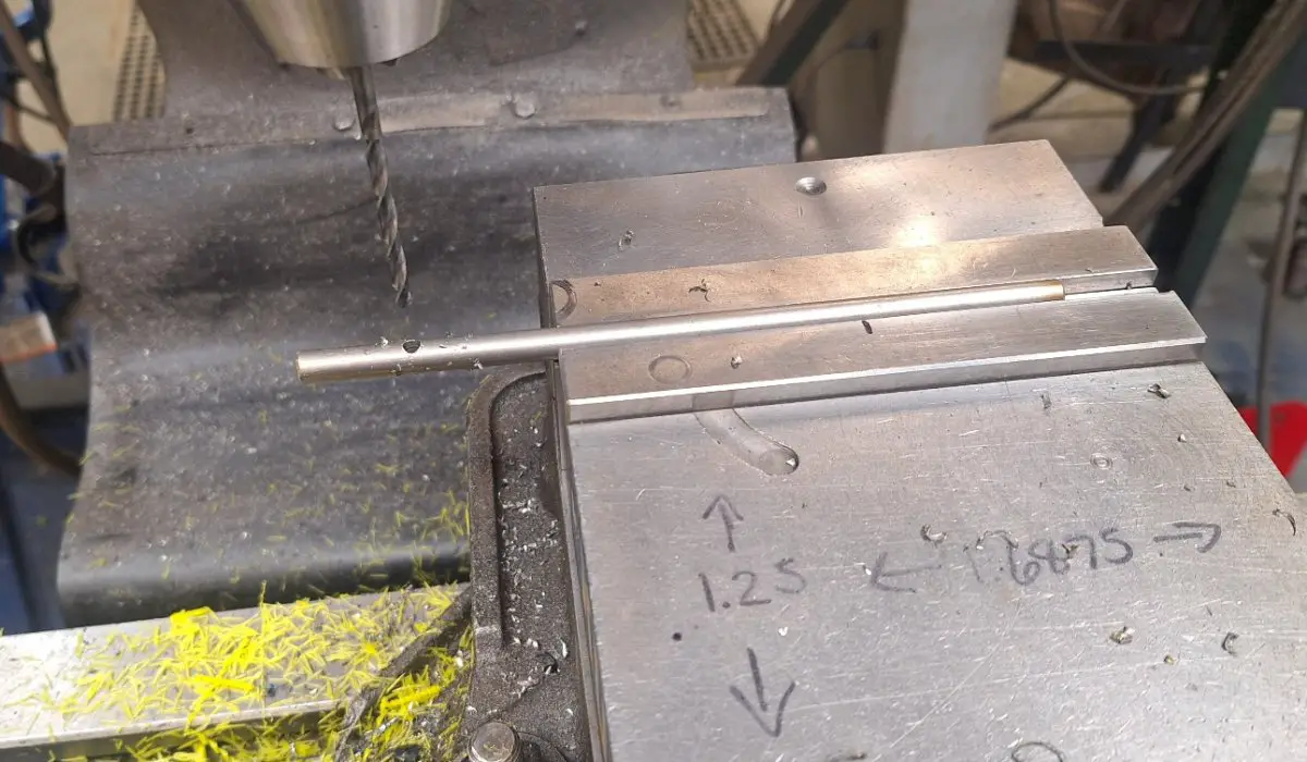

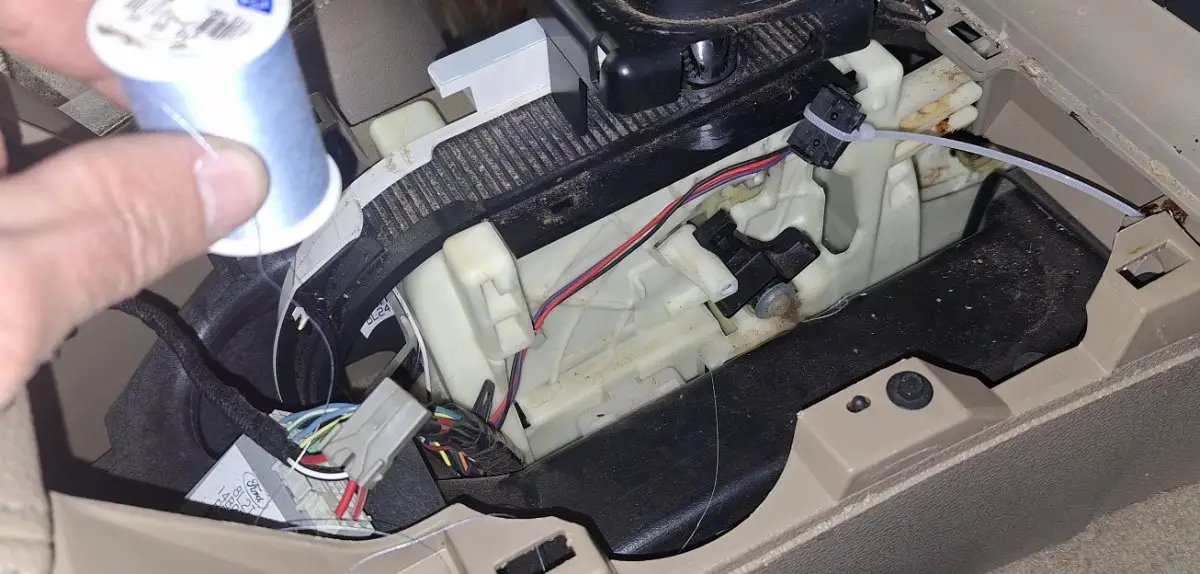

I just did this on an '08 Mountaineer. Yes, reviving an old thread because all this should be in a central location rather than spread across numerous threads.
Many thanks to the users who pioneered this fix! I used 5/16" stainless rod. The pin was long gone so I used a 5/32" roll pin.
Dealing with the OD cancel wires sucks, I used thread as a fish tape. Also getting the broken lower plastic rod out is problematic but I used Milwaukee Air Tip attachments on my shop vac and it worked beautifully.

Also, I put the hole 1-1/16" from the end. Others say 1-3/16" but that didn't correspond with my measurements of the old piece. That said, it's pretty forgiving and I don't think it matters, especially if you're just saw cutting OAL.
