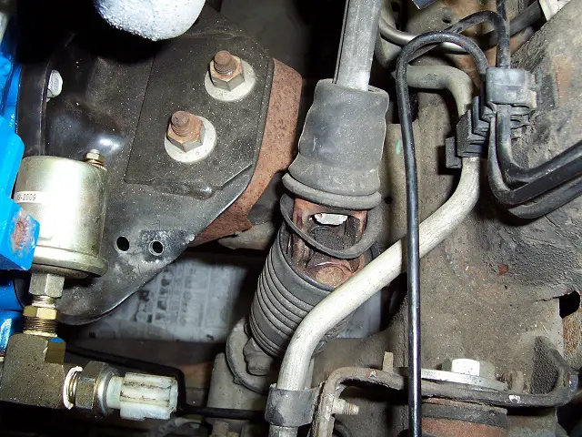

I just thought I would make a thread on repairing the lower steering shaft. During my search to find a replacement for mine, i realized that the only ones out there are aftermarket ones (about $135) or junkyard ones ($10-$20). I wasnt willing to pay that much for an aftermarket shaft, so I went searching at my local junkyard. Out of about 20 explorers, 3 had decent shafts left in them. I pulled the best one out of the 3 (no play in the joint area no matter how hard i worked at it).
I took it home and ripped off the torn boots, soaked the joint in Wd40 and cleaned out the crud. Next I packed it with grease and worked it in.
I realized i needed rubber boots, but couldnt find these online and wasnt willing to even ask my local dealership about them $$$. So I got an old bicycle inner tube and cleaned it up with alcohol. I was able to stretch it over the joint and put a thin strip of silicone under the ends. from there I used zip ties and got them really tight with pliers. (pic below)
Before I install the shaft, I am replacing the firewall boot (you may want to inspect it also). Once its on, I'm going to coat the new boots in PB blaster SILICONE (very important!!!) spray lube to elongate the life of the boots. Regular PB blaster will turn your rubber to mush.
Side note, I sanded down the aluminum joint housing and painted over it half for looks half because the aluminum was oxidizing.
I hope this helps anyone with lower steering shaft problems!! If someone is desperate for one, pm me because I will be heading to my local junkyard again soon and can grab one that you can either refurbish yourself or I can do it for you.
Keep in mind this is not going to be better than the aftermarket shaft, but for $14 and a few hours of time, it worth it to me!! looking to get a few years out of it.
