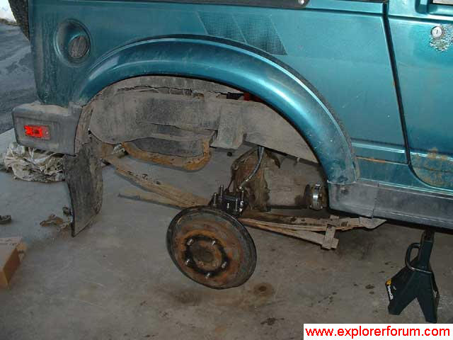

Here's the front of the Zuk minus the axle as it gets ready for the SOA:
Here's the back of the Zuk minus the axle:

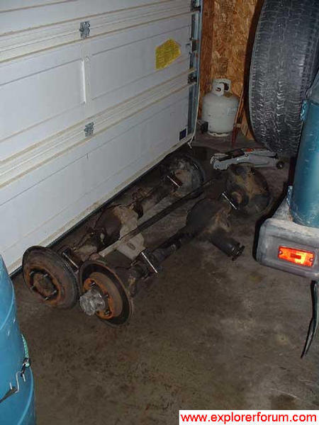

Here are the axles ready to get the new spring perches and shock mounts welded on:

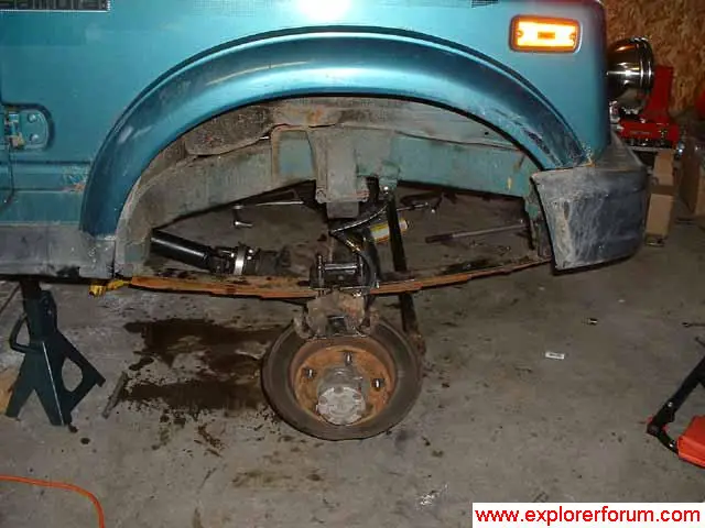

Here I am with the Zuk after taking out the axles, steering and shocks (about 4 hours of work). One thing I will say is that it is EXTREMELY easy to work on the Zuk!!:

Here is the rear axle installed after I welded the new perches on it. You can also see the driveshaft spacer:
Here is the front axle installed, along with the front driveshaft spacer. D*&n steel brake lines on the front were rusted to the nuts, so they broke when I tried to remove them. A quick trip to Advance Auto fixed that problem. Big mess on floor is brake fluid from the cracked lines :rolleyes:

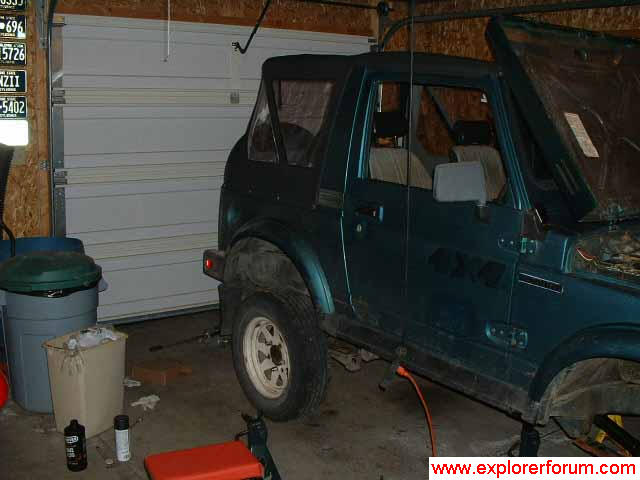

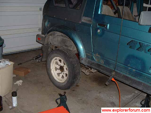

Here is a side shot with the stock rear wheel on. It's actually sitting on the tires, not jackstands! My new wheels are out at the sandblaster's getting cleaned up. They will be painted grey hammercoat and have 31" m/t's on them.
Another side shot:

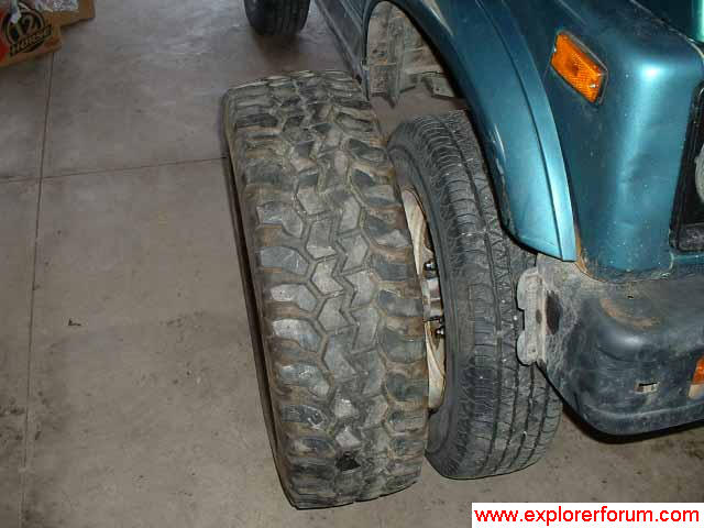

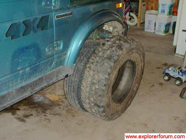

A couple shots of the tires that are going on when I get my rims back. They make the stock tires look a little puny, don't they??
Nice! Any driveline vibes? What are you doing with the gears? With those tires and keeping in mind the weak Sami engine is mated with 1:2.02 gears in the "short" box, you will be running rather than crawling :D

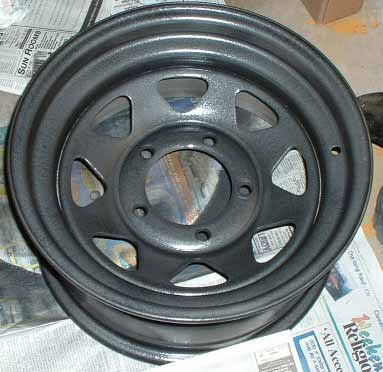

Well, FINALLY got my rims back from the sandblaster. Here one is with a coat of paint on it. Hopefully I'll get 'em all painted tomorrow so they can go get the tires mounted on Wednesday :)

Rims are 5 on 5.5. Sandblasting cost me $40 for all 4 wheels. The paint is Rustoleum Hammercoat "black" (more like dark grey)

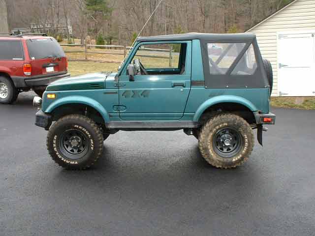

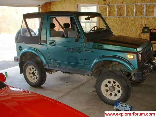

Well HERE IT IS!!! All grown up and ready to play. Next up is a custom front bumper.
Here it is next to a standard grille propane bottle so you can see the ground clearance I now have :D
What youre not gonna park on top of the propane tank? the zookie is light it wouldnt crush it. yeah on second thought better not might roll it.. :D
