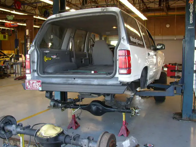

I started my 9" project last week wednesday. This was an easy project but I took my time on it. It should be done this week and tested soon.
Parts:
-narrowed 1979 Ford 9" by 3 inches on both sides.
-5.13 gears and a detroit locker.
-Dutchman alloy axles

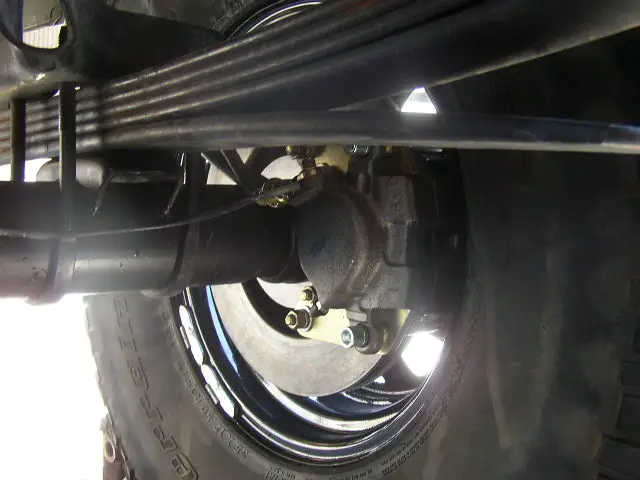

-TSM disk brake conversion using front chevy calipers (no parking brakes)
The 8.8 taken out and 9" placed under the explorer

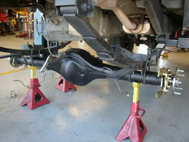

closer view, axle's pinion angle at 20 degrees.
tire mounted
this is how it sits right now.
I need some shock tabs installed and the drive shaft flanged end replaced with a 1330 yoke. More pics and updates in a couple days. :chug:

Very Nice!! :thumbsup:
Is the TSM disc kit bolt on? If you don't mind, what do they run?
Good luck with the rest!!! :)
Thank you! They are bolt on and the price is $295 at broncograveyard.com. This don't include the calipers or outer brake hoses.

Stainless Steel Brake Corporation has a disc conversion kit for the Ford 9" axle but I'm not sure of it's price. BTW, nice install, looks great.

I bet it was soooo nice to have that lift at your disposal....lookin tuff! :smoke:
Yeah definately looking GOOD! Looking at the pictures from the rear, the rear sits higher than the front? Or is it just the angle of that last picture?
Joey P- the rear does sit a little higher. :)
V8BoatBuilder- It's welded, the last 2 pics doesn't really show it. ;)
Yes, it makes the job a lot easier. This is at our base Hobby Shop, three bucks an hour to rent it or $30 for the whole day. The only thing I wish they have is a welder. The welding room is across the building, where my vehicle is at on the last 2 pics. Still a good deal. :thumbsup:

IT'S DONE!
I finally finished it today. Time to test it out this weekend. :bounce:
shock mounts welded on top of the housing...
driveshaft with 1330 yoke end.
