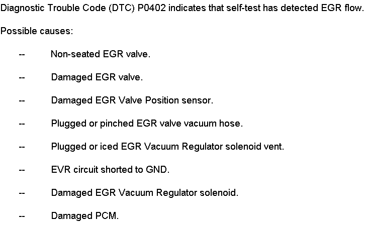

I have replaced the egr, the sensor that bolts to it and the solenoid that the the vacuum hose connects between egr and the solenoid. The explorer is a 96 v8. The first garage said it was the dpfe sensor but there is no dpfe on it. I was told that the solenoid shouldn't send vacuum to the egr at idle.
Thanks for any help.
